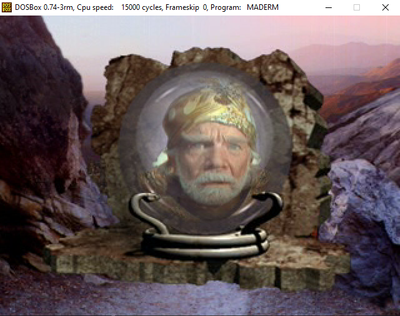

Hey Guys,
We have been working on a ReelMagic DOSBox emulator. The current status is that it can run Return To Zork decently. A complete play-through of RTZ yields a few acceptable glitches here and there, but for the most part, it's not bad. There are several bugfixes in the works as well as work to generalize the emulator so that it is compatible with other DOS ReelMagic games of that time. TBD WIN 3.x support.
The code repo can be found here: https://github.com/jrdennisoss/dosboxrm
Currently a Windows release binary (tested on win10) is available if you don't wanna compile it yourself: https://github.com/jrdennisoss/dosboxrm/releases
(Note: compilation instructions are no different than stock DOSBox)
Would love to contribute this back to the DOSBox project, however I'm not quite sure how that process works or if the DOSBox team would want this as part of the core codebase, especially considering that this modifies the way video output works as it needs to mix two outputs into a single picture: VGA and MPEG. (or at the very least have a serious discussion about architecture) If anyone has any insight or could point us to in the right direction on this that would be appreciated. I'm assuming posting to this forum is a step in the right direction. 😀

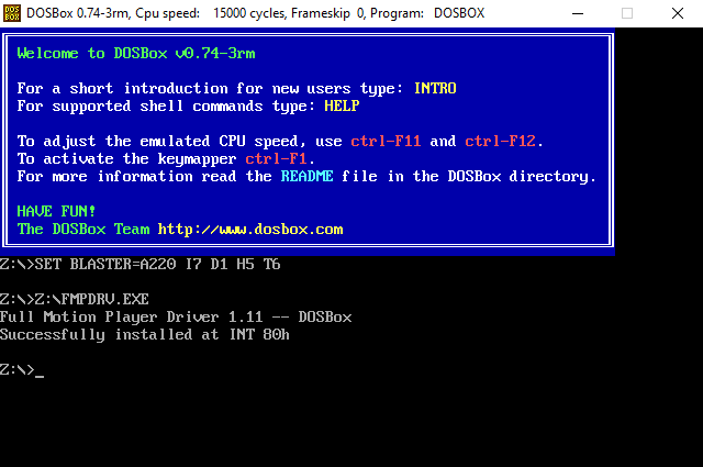

    9.46 KiB
    6431 views
    Loading the emulated FMPDRV.EXE file

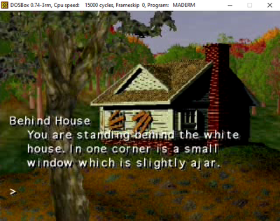

    Return to Zork ReelMagic Version Running in DOSBox
    161.81 KiB
    6432 views

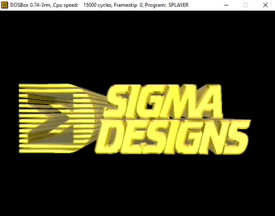

    45.07 KiB
    6432 views
    Sigma Designs Logo Running in SPLAYER.EXE in DOSBox

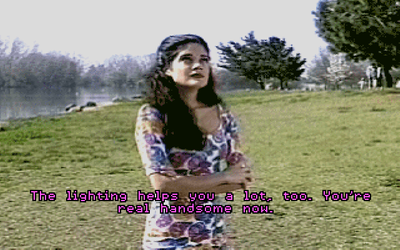

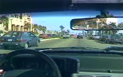

Reply 5 of 172, by Uka

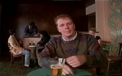

Tried a few ReelMagic games:
"Return to Zork" and "Man Enough" seem to work! Although there are no subtitles displayed in videos for some reason.
"Flash Traffic" and "The Horde" launch fine, but no video is seen.
And "Crime Patrol", "Drug Wars" etc. do not recognize the card.
"Space Ace" launches, but the video is not correct.
Yeah I had a feeling there would be more problems with MPEG decode. While inspecting a handful of MPEG files from several ReelMagic games, we discovered that most of these are not in spec with the ISO/IEC 11172-2 (MPEG-1) standard. To make this just work for Return to Zork and Lord of the Rings, I put in a workaround which pre-scans the ReelMagic-specific MPEG files looking for an "f_code" value that I just slam into the decoder statically, which surprising seems to work pretty well for most ReelMagic encoded videos. We are currently working on figuring out the algorithm for properly handling on a per-picture basis which should fix issues like this. Thanks the heads up on this as it gives us a known bad reference to test and fix with.
Thanks for letting us know about these issues! 😀

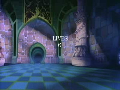

Reply 7 of 172, by Uka
jrdennisoss wrote on 2022-03-01, 17:38:
Awesome! We haven't actually tested "Man Enough" yet but that's pretty cool it works!
Thanks for your great work!
Well, I have only tested the very beginning of it - and it is not possible to complete it anyway as the disk 2 of 3 has not yet been dumped...
And do you know why the subtitles are not showing up here and in "Return to Zork"?
You might be able to get the game to start by manually loading the driver by doing a "Z:\FMPDRV.EXE" before starting the game. There is also a dosbox.conf parameter that can be set to force FMPDRV.EXE to always be there: Setting "alwaysresident=true" under the "[reelmagic]" section in your dosbox.conf file may also work.
Sadly that does not work...
And what does "#vgadup5hack" setting mean? It is not fully implemented yet?
Does "The Lord of the Rings" work for you?
It does not for me: starting a new game shows the video, but then it freezes in the middle. And starting the demo crashed the game saying there is an error in opening the movie.

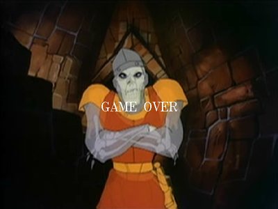

I have also tried "Dragon's Lair": it launches fine, but for some reason only the end game videos appear. As if I just die all the time and nothing else 😀

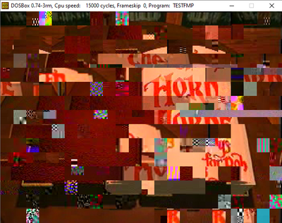

Reply 8 of 172, by Bobbytoz

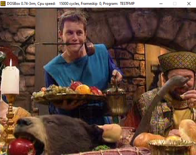

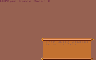

Hello!
Great news! Good job!
Driver 1.11 TESTFMP.EXE
The Horde (- PC RealMagic MPEG DEMO CD_ [MPG](best quality) [MPEG1 Video 352x240x29.97fps 1150kbps])
file.php?mode=view&id=131653
The Horde (- PC RealMagic THE HORDE CD _ [MPG](normal quality) [MPEG1 Video 352x240x12fps 1015kbps])
file.php?mode=view&id=131654
DOWNLOAD VIDEO SAMPLES: https://www38.zippyshare.com/v/fzwlt40W/file.html
The game does not play video(((
    166.66 KiB
    6257 views
    173.02 KiB
    6257 views

Reply 9 of 172, by Bobbytoz
On real hardware RealMagic XCard PCI
Similarly...
MPEG1 Video 29.97fps 1150kbps (works!)
MPEG1 Video 12fps 1015kbps (Frame failures)

Reply 10 of 172, by Bobbytoz
jrdennisoss
Why are you using the driver v.1.11 and not 2.01F ?
Is there a technical reason for this?
I tried to run The Horde game with different versions of drivers (1.10 - 2.01F), does not run the video
Games used to be better!

Reply 14 of 172, by Uka
jrdennisoss wrote on 2022-03-02, 04:43:
Can you tell me where in "Return to Zork" or "Man Enough" you expect to see the subtitles or how to enable?
Sorry, my mistake. I must have confused "Man Enough" with "Flash Traffic" - there are no subtitles in the first scenes of "Man Enough" for some reason, even on the real hardware (must be an original bug). They do appear later 😀
And there are no actual subtitles for the videos in "Return to Zork" either.
So everything seems to be fine!
I have also noticed that the photo screens in "Man Enough" splash too quickly - had to reduce the CPU cycles from 15000 to about 3000-4000.

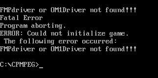

Reply 15 of 172, by KainXVIII
Step-by-step instruction how to run ReelMagic games would be helpful! Do i need to install RM drivers first? Where to get them and which version is better?
PS - what i tried: launсhed RTZ - nothing happened; tried to install RM drivers - hardware is not detected 🙃

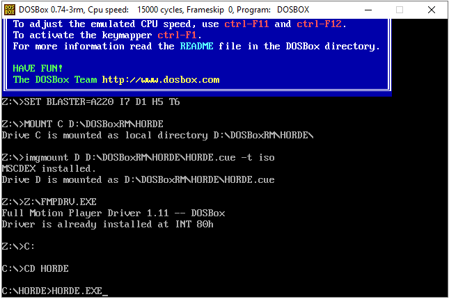

Reply 18 of 172, by Bobbytoz
KainXVIII wrote on 2022-03-02, 07:27:
file.php?mode=view&id=131704
Drivers do not need to be installed...
But here is the driver archive https://archive.org/details/sigma-design-drivers

Reply 19 of 172, by KainXVIII
Uka wrote on 2022-03-02, 11:46:
You do not need to install the drivers - they are already present in dosbox.exe!
Just mount the disk and install the game - everything worked fine for me.
This is what i did for the first time: installed RTZ, launched RTZ.bat and nothing happened, not even an error log.
Maybe something from autoexec conflicts, dos navigator or something else 🤣?
[autoexec]
# Lines in this section will be run at startup.
# You can put your MOUNT lines here.
mount c d:\
mount d e:\ -t cdrom
c:
cd dn
dn
PS - its actually Dos Navigator, if i quit it - game loads, never had this issue before in dosbox *shrugs*
