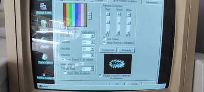

Hi,
in my retro pc with these specs:
  • CPU: Pentium MMX 233MHz
  • RAM: 64MB SDRAM
  • Sound: Integrated CMI8330
  • OS: Windows 95
I've installed a Matrox Mystique paired with a 3Dfx Voodoo1.
I installed the required drivers and tried to play Quake 2: it recognizes the 3Dfx but the sound is really bad (it is choppy).
It seems that even in software mode it's like that, so maybe it is a DirectX 5 problem (dunno 😕).
How can I solve?
I've also another question: is it normal that Quake2 with Voodoo1 runs at ~30FPS?
Thanks in advance.

Q2's fine on a V1. 512x384 is quite well on it. It certainly was the most visually balanced and performant card running Q2 by the end of '97, considering the alternatives....
Is the sound mode set to 'max compatibility' or 'max performance'? I'm assuming there's some sample conversion hiccupery going on (many onboard sound had 48khz native and a lot of choppy sound is due to this)

Reply 4 of 9, by leileilol
Demetrio wrote on 2022-03-04, 08:47:
How do I set this property?
From the Quake2 menu, I've tried with Sound: Low or something similar and I've got the same result.
Sounds like your Quake2 build is too old (v3.0x) to have the feature....
try /s_primary 0
followed by a /snd_restart
in the console to see if that'll help
Reply 5 of 9, by Demetrio
leileilol wrote on 2022-03-04, 09:16:
Sounds like your Quake2 build is too old (v3.0x) to have the feature.... try /s_primary 0 followed by a /snd_restart in the con […]
try /s_primary 0
It worked! Thanks a lot 🍻
Here's the result: Youtube Playlist with the Quake 2 demos running at 512x384
Better than 640x480 but still framerate drops 😕
Going down to 400x200 (IIRC), stable 60 FPS.
Can I improve 512x384 with some settings?
Reply 6 of 9, by leileilol
One of 3dfx's old drawbacks is texture upload speed, so /gl_flashblend 1 should help the drops that happen around dynamic lights.
Always keep 8-bit textures on. 3dfx supports them and this saves memory.
Reply 7 of 9, by Demetrio
I've set the gl_flashblend parameter but I didn't notice any improvement.
Then I tried to disable Sync Glide to refresh and FPS increased.
Here's a footage of the result: https://youtu.be/OlBRJfIUw4U
Is there any other thing I could do to further improve FPS?
Anyway, thanks a lot 😀
