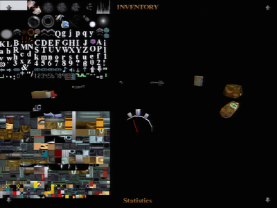

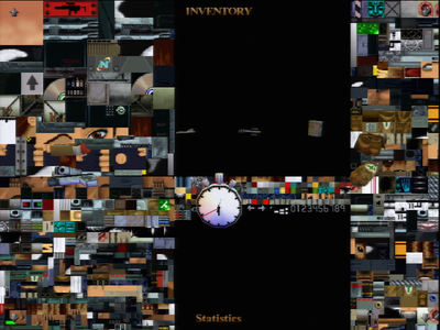

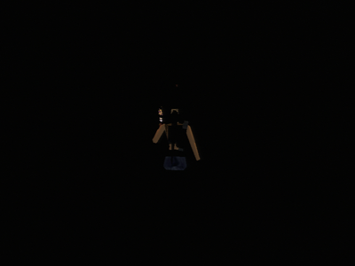

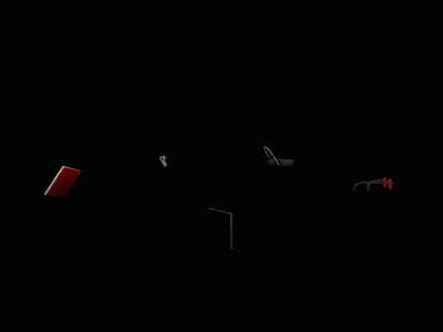

So, I'll go straight to the point. I tried searching around for anybody else having this issue but nothing so far. I've been trying to play Tomb Raider II and III on my old Windows 98 rig running a RIVA TNT2 card, but for some reason the game doesn't load textures correctly or something, so it looks mostly black. If I disable the Z buffer option in TR3, then whenever I go in-game the textures look mostly fine, except that some triangles start blinking white or switching textures for a single frame, and that doesn't fix the issues with the main menu looking all black or the loading screens and menu background while in-game looking like just a texture dump. Any help?
I have both a RIVA TNT and a RIVA TNT2 model 64 on an AGP 2X slot, I am running the ForceWare 71.84 driver on Windows 98 SE. Both cards exhibit the same issues. I tried changing the settings, using different resolutions and color depths, tweaking the little stuff I can tweak on the Windows settings from the driver. Nothing helps. The only thing I didn't try was using different driver versions. I'd assume the RIVA TNT, being contemporary to the games, would work correctly.
This is your problem. Try an older driver like 7.76 and everything will work correctly (and it will also be faster, especially if you have a slower platform).
Those issues you're seeing with the 71.84 driver are the reason why cards like the GeForce 6xxx series are not a viable option for Win98.
