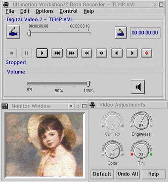

If you're brave, you can also check out the Ultimotion codec from IBM.
It was its answer to Microsoft's Video for Windows or AVI, so to say.
Ultimotion was designed to be of high quality and to be played back purely through software.
OS/2 Warp supported it very well without any stuttering.
However, there's also a codec for Windows 3.1 -pardon- Win-OS/2 available (um4win.zip).
https://www.os2site.com/sw/mmedia/video/index.html
https://m.youtube.com/watch?v=H3BYvPDdRcQ
https://m.youtube.com/watch?v=0nTIkp8Yt_Y
https://m.youtube.com/watch?v=Ml3I_lGi2EI
Edit: Here's a chart for you.
https://sites.ualberta.ca/dept/chemeng/AIX-43 … VideoCodecs.htm
Edit: Found a player for the Amiga platform. Still looking for an encoder, though.
http://aminet.net/package/gfx/show/CyberAVI
Edit: Sample files: http://samples.mplayerhq.hu/V-codecs/ULTI/
Edit: Found a bit of information. In the 90s, IBM's "Ultimedia" and "Video In" could be used to create Ultimotion videos.
Also, converting Indeo to Ultimotion was an option.

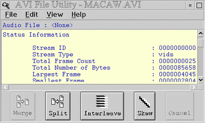

The OS/2 2.1 MMPM/2-based applications that provide video support are:
Digital Video Player
Video In Recorder
AVI File Utility
Ultimedia Builder/2
Ultimedia Perfect Image/2
Source: http://mireality.co.uk/writing/technology/os2 … ox-to-video-in/
