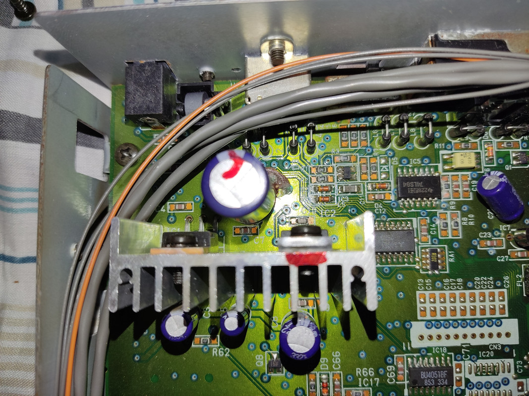

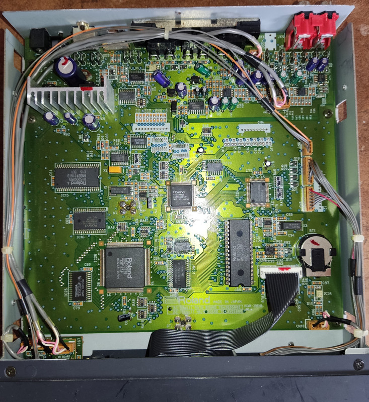

Hello, i'm new on this site, but i already knew him. Well, i have a problem with a Roland Sound Canvas SC-55 mkII that i purchased a week ago, and the problem is that it does not turn on, i tested it with any power adapter. Two power adapters that i tested, they showed a blinking light when i connected them to the unit.
I opened the unit, to see if the internal battery was installed, and has it, but besides, it seems to be no damage, except for a few small red stains, but i don't think it affects the unit. A friend says me that use the official power adapter manufactured by Roland, but i'm not convinced that the problem be the manufacturer. I have a Yamaha MU1000 and works fine with any adapter that's not Yamaha, as long as it complies with the required voltage, amperage and polarity. I don't know what the problem and i don't know it has solution.
I leave a image of the opened unit, if you can see what is something wrong. Perhaps you know more about this...

Can you provide a close-up / macro shot of the top left area? Here at Vogons we have seen some units have issues in that region. i.e. corrosion around the base of the large capacitor. You may want to investigate that in order to confirm or rule it out.

Thanks! I can't immediately diagnose from the image, but others may find it useful and may have opinions. But let's focus first upon the power adapter:

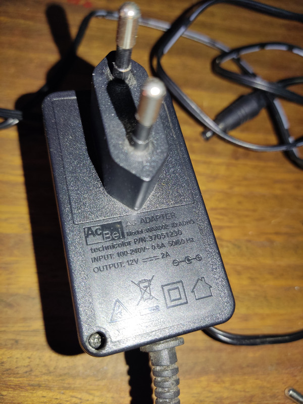

Well, this same thing i made in my MU1000 the last year, but as i say, back then, i didn't notice about polarity, neither amperage, only the voltage. Good thing they were all center positive, in fact, the first that i used is of my Yamaha keyboard, until i get a Yamaha power adapter, but a days ago, i noticed that the adapter is 700mA, less than requires the unit (2A), and i worried that, because due to the lower amperage the equipment can be damaged. I stopped using it, but luckily, i found in home an adapter, that is not Yamaha, but complies accurately what is required (12v - 2A - center positive) (all this time was at home that adapter and never i noticed... i feel stupid).
I leave a pic of him to confirm.
Pic

I will get the PSB-120, has a design that i don't like much, but is the only one that is center negative, while all the ones that i find are center positive, but besides this is 2A (more than you recommended), is suitable?
Yes the PSB-120 is perfectly suitable.
The 2A max Current rating of that adapter is fine. The PSB-120 is voltage regulated, meaning it will consistently deliver the rated 9V, whether loaded by a 100mA device, or the full 2000mA load, or anywhere in-between. Therefore, it will do no harm to your Sound Canvas. The Canvas will pull only the Current it needs.
The remainder of the PSB-120's Current capacity will simply sit unused, and the power supply unit will run cool & comfortable (and have a longer life span) as a result of that modest utilisation.

Hi, regarding your problem, I think it is due to the large capacitor on the power line: it is evident that it has leaked from below (i.e. the capacitor needs to be replaced .. and see to respect not only the polarity during installation, but also voltage, capacity and operating temperature of the original capacitor) and that you will have to replace it as well as clean up the traces around it to avoid corrosion.

It's understandable to come to that conclusion. You see a substance beside a capacitor. You assume capacitor leak. It's natural.
However, based upon previous discussions here at Vogons regarding that particular capacitor in Sound Canvas units, the community consensus is that the brown substance here is a type of adhesive. The substance has certainly been found to cause problems in the units of selected users, no doubt. (conversely, others with the substance have no corrosion)
But the first and obvious necessary thing in this situation, before anything else can be confirmed or denied, is to have the correct power supply.

Hello, it's me again. Finally the PSB-120 has arrived this morning (10 am GMT-3), i tested it and... WORKS! I was afraid it wouldn't work and possibly a diode would have been damaged (due to the testing with wrong adapters) but works, and now i enjoy it! Thanks again.

The red stains within the unit, is adhesive? I thought that are only stains... well i hope that don't cause problems in my unit. I used it, and i haven't had problems because of that until now.
