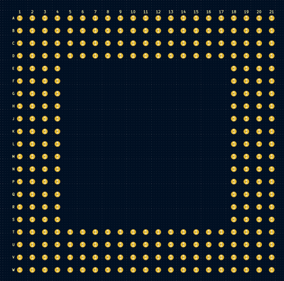

Anyone able to confirm this pin spacing with a caliper?
Here is a socket 3 footprint I threw together based on the pentium overdrive datasheet.
I need beta testers btw.
Need active feedback and engagement. or this probably won't get past alpha/beta
footprint alpha 1

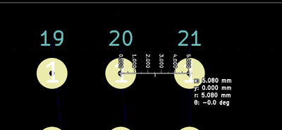

So let's do this once again. With the latest creation that gives me nightmares.
Tweaker 3
20.14 KiB
2508 views
- The pin spacing is 5.08mm instead it should be 2.54mm
- The pad hole sizing is wrong, you want the mid point of 0.43-0.51 mm which is the pin thickness margin on Socket 2,3,4,5 and 7. ( 0.47mm pin diameter with a +/- 0.04 machining tolerance)
- The pad numbering is completely horrifying, no sane designer would make every pad the same Reference ID. Use the X,Y array creation feature to build the pads with the right spacing and numbering.
Which tells me you do not even know how to use the KiCad array functions.
Having everything be the same Pin will violate all Design Rule Checker (DRC) and Electrical Rule Checker (ERC) rules and allow connecting any track to any pad or absolutely anything else.
- All of the physical dimensions to create a CPU/Socket footprint, the pins to create a symbol is clearly documented in the datasheet that you have actually attached as part of the ZIP upload attachment.

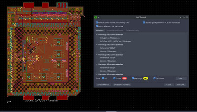

Socket 5/7/SS7 (Voltage Interposer) Tweaker. (Alpha)
266.71 KiB
2508 views

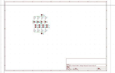

All those little arrows are faults, due to no reference schematic or annotation of unique reference ID's for parts.
- You've built that whole thing without even a schematic!!! Frankly I don't know wether to be impressed, horrified, or everything at once.

- There are no net-rules, no schematic, just the stuff of nightmares
220.85 KiB
2508 views

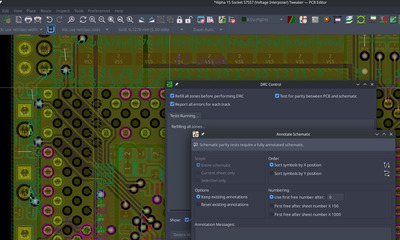

- DRC checking results in a Krakatoa explosion of errors
220.85 KiB
2508 views

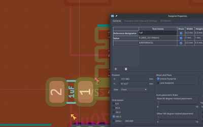

- Components have schematic values as reference designators (ref designators should be unique)

The literally only thing I was asking was pin spacing. I referenced the pentium overdrive spec sheet which seemed to indicate .2” pin spacing. As for the pad hole size I set that to .016” on purpose. My latest shim tweaker is prototyping that change to attempt to make press fir work, which was a success on the processor interposer tweaker at a different size. (Something you said would never work), it does.
I’m just wanting to confirm spacing,
This is why I asked. In case there was a issue, so I can fix it early on. Thanks for confirming that the spacing needs adjusted. I appreciate that and will make a new one and confirm it before moving forward. See I was unable to find a footprint to use so am having to make my own.
