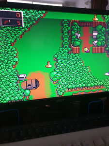

I have a weird problem while playing Keen 4/5 on a pentium 233mhz pc + diamond stealth 2000 2mb (S3)
When moving with the arrows, monitor flicks:
1.96 MiB
1097 views
See the black lines.

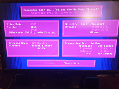

I can fix the problem by checking the "SVGA compatibility mode" in the game's options.
BUT
When I do that, the game wouldn't load the next time.
It gets stuck on Loading... please wait until I copy the game again.
1.41 MiB
1097 views
Reply 3 of 16, by keenmaster486
https://gona.mactar.hu/DOS_TESTS/
Check this chart. LCD vs CRT monitor does have an effect on Keen sometimes.
However I don't think that's the issue here, since the chart says "serious display problem" for Diamond Stealth 3D 2000.
Maybe try a video card that is compatible with Keen according to that chart.

Reply 4 of 16, by maxtherabbit
The real issue here is why the game won't load for you after saving the "SVGA compatibility mode" setting. That setting exists to fix your exact problem, and it should in no way stop the game from loading

Reply 6 of 16, by idan182
I made some tests
so It's not something with the "SVGA compatibility mode"
on Win 98 game always work.
In DOS, sometimes stuck Loading.. Please wait.
I checked, and if I touch or click on my mouse, game starts!
I have tried it a couple of times. When it's stuck on Loading, I can't press any key on my keyboard.
Also ALT+CTRL+DEL won't work, and also Num Lock wouldn't respond.
So I guess it's something with the mouse/drivers on DOS only...
