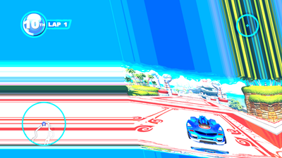

Hi, I'm using v2.78.2 for this game, and here is what I got:
The attachment SART.png is no longer available

Hmm... what is this? What config do you have for dgVoodoo and the game? I can't repro such a thing, the game is working fine for me.

Thanks for the reply! The dgVoodoo settings are the default, except VRAM is set to 4096MB. The game is set to 2160p Fullscreen High Quality. I also tried 1080p and Windowed mode and the problem is the same.
The PC specs: Windows 11 Pro 21H2, 3080Ti with v512.59 driver, i5 11400F, DDR4 8GB*2, Z490 chipset.

I have the same problem, the last version that seems to work is 2.77. Unfortunately if I use that version, I sometimes (seems stage dependent) get texture corruption or something on reflective surfaces, but I'm guessing that's been fixed based on the current version despite the skewed view.

Indeed, my bad. It's Sonic and All Stars Racing Transformed...
Anyway, I fixed the bug.
