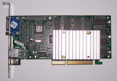

Voodoo3 has a 3.3V port with the "key" towards the back plate:
109.69 KiB
1728 views

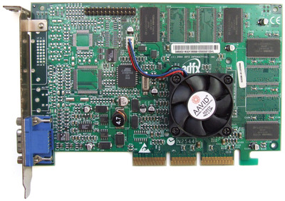

The only 3dfx card you can use with MS7047 would be Voodoo4 4500 with both 3.3V and 1.5V keys:
669.36 KiB
1728 views
IMHO Radeon 9x00 series would be a more practical choice.
