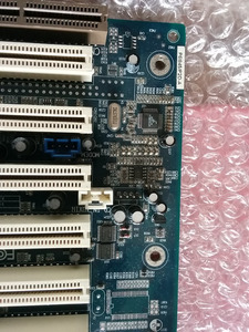

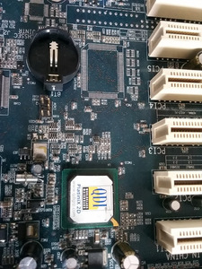

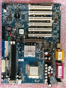

Reply 2 of 27, by melbar

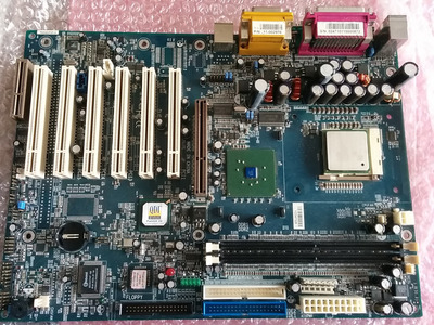

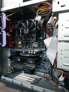

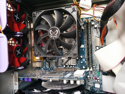

The socket 478 platform:
261.24 KiB
2474 views
GPL-2.0-or-later
172.17 KiB
2474 views
GPL-2.0-or-later
209.78 KiB
2474 views
GPL-2.0-or-later
205.31 KiB
2474 views
GPL-2.0-or-later
381.86 KiB
2474 views
GPL-2.0-or-later

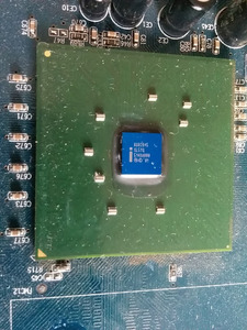

Reply 3 of 27, by melbar

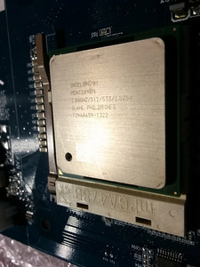

The chosen CPU:
127.14 KiB
2473 views
GPL-2.0-or-later

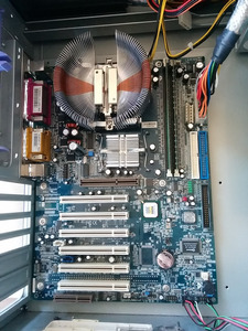

Reply 4 of 27, by melbar

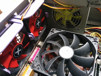

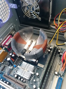

This is the CPU cooler i have selected. An unsed Zalman with Al - Cu combination.
The pictures are taken before i had to cut the plastic on the sides.
After installing the heatsink onto the CPU, the next disappointment ..... 🙁
Very noisy, even at the lowest setting of the FAN mate control.
Then i saw that the fan was spinning unbalanced.
I have removed the fan and the next step will be a 120mm fan mounted onto the zalman.

Reply 5 of 27, by H3nrik V!
Must be damaged somehow. Back in the day, IIRC those Zalman coolers were known as being very nice and quiet ..
Reply 6 of 27, by pentiumspeed
H3nrik V! wrote on 2022-05-11, 20:36:
Agreed! Had this also and was nice. This was one of my mods to quiet the PC down, had to make a adjustable voltage regulator on a prototype board for fans.
Another is Alpha PAL8045 heatsink with fan's voltage regulated down, still have this heatsink, only issue is weight.

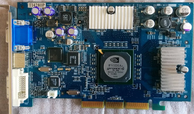

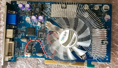

Reply 7 of 27, by melbar

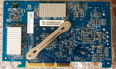

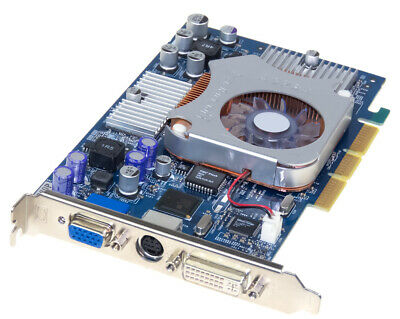

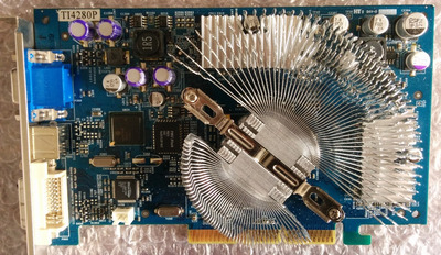

Here now the same with my VGA card. The original heatsink was too loud.
From china i had bought a cooler replacement, but again is little noisy to my purpose.
At the end, i come to the same solution than my previous built and i am using a dual 80mm fan slot bracket solution.
(The figure with white background is for comparison from a google search, can't remember it had exactly this heatsink.)
29.27 KiB
2252 views
GPL-2.0-or-later
303.3 KiB
2252 views
GPL-2.0-or-later
326.44 KiB
2252 views
GPL-2.0-or-later
338.58 KiB
2252 views
GPL-2.0-or-later
254.54 KiB
1997 views
GPL-2.0-or-later

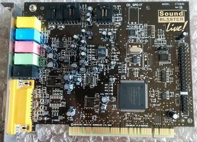

Reply 8 of 27, by melbar

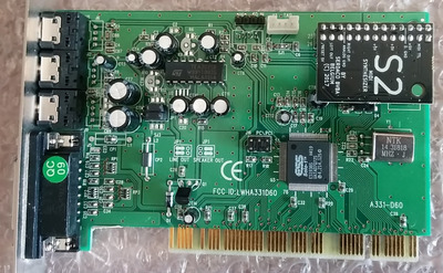

The chosen sound cards.
231.29 KiB
2252 views
GPL-2.0-or-later
326.35 KiB
2252 views
GPL-2.0-or-later
Reply 9 of 27, by mockingbird
How did you get your SOLO to work with SBLink and the Platinix? I have the Platinix SDRAM version and there's no option to set plug and play OS to yes in the BIOS which they say is a requirement...
I also tried using PCISET per the thread that describes the process.
Yet every time I load the ESS Solo file it shows as being set in TDMA mode or something the other, and it stays loaded as a TSR.
The Yamaha YMF724 works flawlessly though with PC/PCI and the modified SETUPDS.
(Decommissioned:)
Reply 10 of 27, by melbar
I don't understand your problem completely i think.
I have initialized the card with 'essolo.com' in DOS mode. Then it is showing:
DMA Mode is TDMA
Current Solo PCI IRQ: 3 PCI IO Base: 9000
Current Solo SBPro Game Settings:
SB IO=220h IRQ=5 DMA=1
MPU401 IO=330h
Game Port IO=201h
I have checked the sound with TES Arena in pure DOS.
  • FX - soundblaster /or SB16 compatible setting, music - soundblaster /or SB16 compatible setting --> is working for both settings
  • FX - soundblaster /or SB16 compatible setting, music - general midi /MPU401 setting --> is working for both settings
Note:
According to this thread, Stainlesscat has stated, that the ESS Solo-1 does not need/use the TSR program to work in real DOS mode.
ESS Solo-1 - pure PCI vs. SB-link

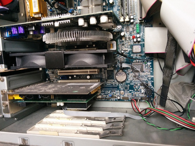

Reply 16 of 27, by melbar
Here the inside pictures, before i have removed the PC-PCI cable.
179.76 KiB
1990 views
GPL-2.0-or-later
331.58 KiB
1990 views
GPL-2.0-or-later
363.53 KiB
1990 views
GPL-2.0-or-later

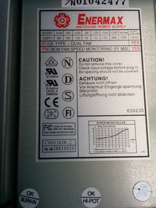

Reply 19 of 27, by melbar
The PSU was changed previously from Levicom to Enermax.
281.96 KiB
1926 views
GPL-2.0-or-later
105.98 KiB
1926 views
GPL-2.0-or-later
