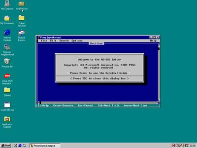

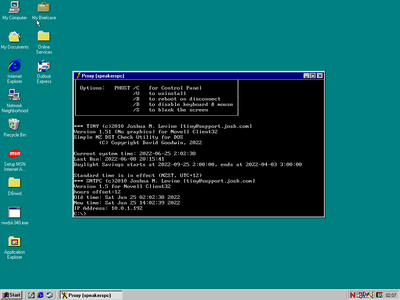

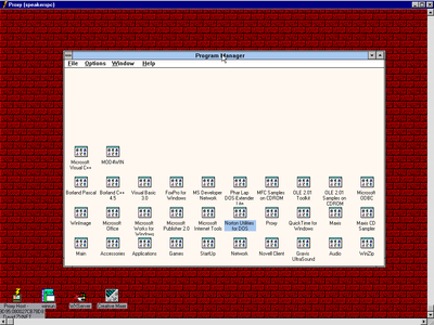

Reply 5 of 13, by davidrg
Bit off topic but as far as remote control goes, there is also TINY which supports graphics under DOS to some extent. Works over TCP/IP. Doesn't support Windows 3.x though - in my testing it tends to crash the machine if you start windows while connected remotely. Host TSR is free for non-commercial use, client (java) is open source. The client currently requires an older version of Java but the bug it experiences with current java is probably not too hard to fix.
I've also used Proxy by Funk Software. Its proprietary software and probably pretty hard to find legal copies of it now - my copy came as part of the Seagate Desktop Management Suite. Works over both TCP/IP and IPX and can remote-control DOS, Windows 3.x and Windows 9x. I think its more geared to remote-controlling Windows though - IIRC the DOS portion only supports IPX and doesn't handle graphical DOS apps very well. The client for the version I have doesn't seem to support Windows NT (incl. 2000/XP/etc) either. Performance is very good though - much better than VNC. Still not good enough for for playing windows games remotely on my DX4-100 at least.
