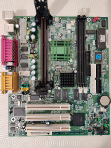

First post, by NyLan
Got this mobo, some caps need replacement.
But I'm not sure it's worth fixing it. No AGP, No ISA, ...
What do you think ?
MSI MS-6190 Ver1 Medion 9901 Mainboard, Intel 440ZX Chipset... with Integrated TNT2 M64

Reply 1 of 22, by Repo Man11
I would repair it; I enjoy fixing things.
After watching many YouTube videos about older computer hardware, YouTube began recommending videos about trains - are they trying to tell me something?
Reply 2 of 22, by paradigital
Looks like there’s an unpopulated ISA slot. If there’s a variant of this board with ISA, I’d be tempted to add the slot and any required passive parts whilst doing the recap.
No AGP is a bit of a downer, but the onboard M64 will be good enough for a lot of games.
Reply 3 of 22, by RandomStranger
With an integrated TNT2 M62 and for example a Celeron 300A it can make a solid budget build. It also has an on-board Ensoniq AudioPCI, which has mixed reputation, but could be worse. If it can be modded to have an ISA slot that makes it better. Recapping is also a cheap repair and Slot-1 boards are starting to get pricy. I'd go for it.

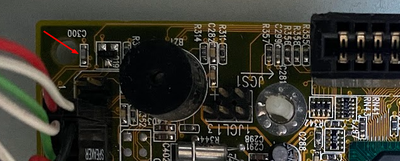

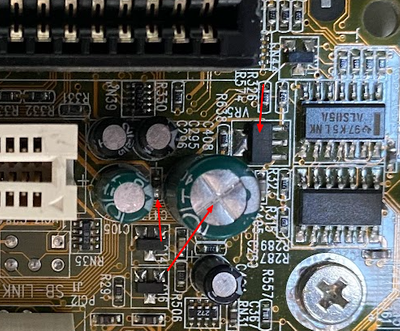

From your picture what is missing near ISA slot on mine
The attachment 1.png is no longer available
The attachment 2.png is no longer available
And near CPU :
The attachment 3.png is no longer available
soldering caps is ok, SMD can be tricky at some point

Reply 18 of 22, by majestyk
I don´t think the transistor in lhe last picture between CPU slot and RAM slot is related to the ISA slot. It´s probably "Q15" on your Medion board.
