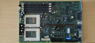

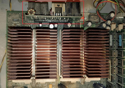

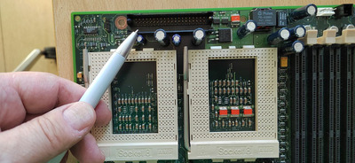

Hello, I'm looking for a Voltage Regulator Module (VRM) for the 2nd Pentium Pro processor of the newly acquired IBM Personal Computer 365
Nowhere on the internet do I find the exact model to look for at least on Ebay or I don't know where.
Any help, information on this board is welcome.
Attaching photos.

Reply 1 of 24, by Horun
Because that board has Intel chipset and Intel CPU's it should follow the Intel VRM design guidelines, this one should apply to that era (1995) of Intel based P.Pro motherboard
sorry should have added that probably all Pentium Pro VRMS should work, a Pentium or P2 VRM most likely not for various reasons....
Reply 2 of 24, by PC Hoarder Patrol
The info I'm seeing online quotes two different IBM part numbers - 76H1815 and 07H1097 - the first is rated to 11.2A for 200MHz/256Kb cpus and the second is rated to 12.4A for either the 200MHz/256Kb or the 200MHz/512Kb cpu

Reply 5 of 24, by Horun
Hahaaa 😁 not a mythical part, same two VRM's were used in the Server 325 and 330 also 😀
https://www.ibm.com/support/pages/processor-a … s-pc-server-330 and https://www.ibm.com/support/pages/specificati … er-325-8639-esv

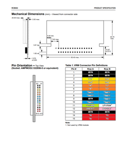

You know what, I think it’s about time we made a (easy) DIY way to address this. There are a lot of motherboards out there with this header.
Can you upload the pinout of this, and the socket 7 header and I’ll make a pcb for tapping it. I believe the socket 8 and 7 header may be different. There is supposed to be a builders guide or a spec sheet for this connector somewhere, but I am not hone right now,
Edit: I see someone found the pentium pro guide sheet
anyway, my thought is to combine the pins into pads and make it easy to tap and run it off of the regulator of your choice. Similar to what we have done with the socket 5/7/ss7 tweaker and the socket 1/2/3 tweaker.
Something I ran into on designing the socket 5/7 tweaker is trying to make your own regulator has a huge Bill Of Materials. And requires significant soldering skill to assemble.
Something that can be solved by simply making a device for tapping it, not powering it. And use simple cheap off the shelf power supplies in line on the power cable.

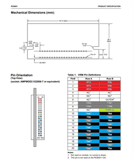

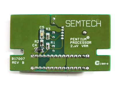

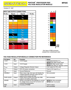

Reply 9 of 24, by Horun
Sphere478 wrote on 2022-06-25, 23:01:
Here are my Fairchild and Semtech VRM datasheets (with board size and pinouts) for actual VRMs for Intel P5 and P6. If you need something more let me know have a few more on my other computer somewhere..

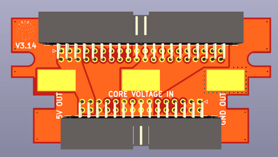

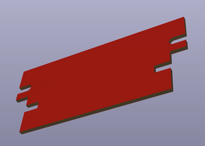

What do you think of this so far?

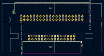

Reply 14 of 24, by Sphere478
Damn, listed as 47w that's a needy chip..
No problem, the VRM won't be on the device I'm making it will be external. (like a power adapter) I'll be sure to plan for that amperage on the board.

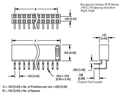

Okay, so it looks like these vrms used a weird female pin header.
970.83 KiB
1397 views
do we have a pn for that? otherwise I'll design it for use with normal 2.54mm horizontal headers. but we'll loose a fair amount of room to the pins.
as you can see if I place the normal headers at specified location they hang off the board.
102.05 KiB
1397 views

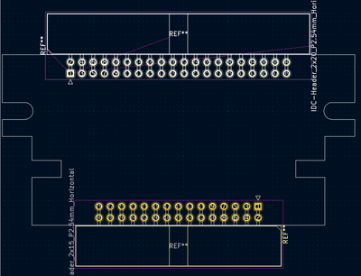

Reply 15 of 24, by Sphere478
here it is with the popular pin headers aligned
not much room left. But it's enough.

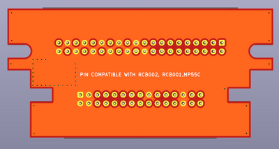

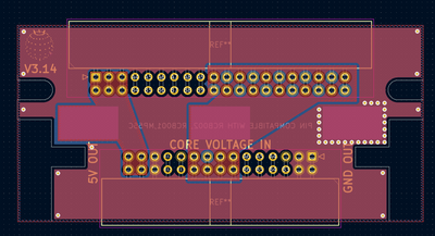

Reply 16 of 24, by Sphere478
VRM Tap 3.14.zip
1.38 MiB
55 downloads
double check me here, lemme know if you see anything routed wrong, wrong size etc. it's 3:45AM here I'm tired 🤣.
Btw the 3d model is of the male connector, obviously you'll use the female connector.
As for what power supply to use with it, do you think a dual VRM version of CalamityLime's board would work? (a single may actually work for some Pentium pros, it's rated for 12a.)
If the cpu takes 3.3v btw, then you may be able to hook up to atx/sata 3.3v, maybe add a noise filter though for good measure.
2239371.pdf
1.32 MiB
54 downloads
-Known error forgot space on listed models.
Use at own risk, check for shorts before powering on.
    140.94 KiB
    1384 views
    48.46 KiB
    1384 views
    59.42 KiB
    1384 views

Reply 17 of 24, by weedeewee
sphere478, according to the pdf posted in this thread, a pPro also needs 1v5 .
Do not ask Why !
Reply 18 of 24, by Sphere478
weedeewee wrote on 2022-06-26, 11:31:
5v? Shouldn’t the motherboard supply that?
Where are you seeing that? Screen shot it for me please. Lemme see if I can address it.
Sphere's PCB projects.
Reply 19 of 24, by weedeewee
Sphere478 wrote on 2022-06-26, 11:37:
1v5 1.5V
