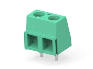

Reply 101 of 223, by Kahenraz
If you want it to be optionally direct solder, then give it a through-hole footprint that can accept a terminal block for those of us who don't want to crimp our own spade connectors.
I like spades, but I hate crimping.
Reply 102 of 223, by Sphere478
CalamityLime wrote on 2022-06-25, 03:16:
Sphere478 wrote on 2022-06-25, 01:51:
CalamityLime wrote on 2022-06-25, 01:39:
yeah I was thinking that molex to berg cables are really cheap, so cheap I'd bet that you may have one or two kicking around your house. So if you wanted to DIY things, you could cut up a berg cable and rock on with your own thing.
I added the jumpers for 5/12v for the reasons I pointed out in the original post.
I also made the power out side a solder joint because it looks like you're expected to solder the wires to the interposer (unless I'm reading things wrong)
I’m going to examine it in physical form and see what makes sense. But spade or direct solder seems to be the way it is headed.
So do you want me to continue or are you deciding what ports you want?
I’m talking about the tweaker. No effect on your part. Interested to see what you come up with. Thanks for contributing 😀
Kahenraz wrote on 2022-06-25, 04:11:
I thought about a terminal block.
Seems like overkill. One of those big aluminum ones I mean.
But maybe one of those small green ones might be perfect..
I don’t think they can carry as much power as a spade though.
Crimping spades is easier than soldering terminal blocks.
Much of this, the user will come up with all sorts of ways to accomplish I suspect.
Sphere's PCB projects.

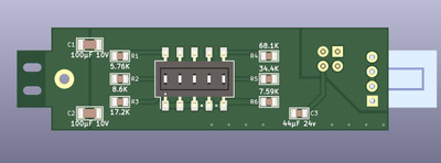

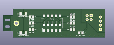

Reply 103 of 223, by CalamityLime
right so, I've ran the connections. Most connections are made with floods which should be good for noise and heat.
I also got it back down to a 2 layer board which is handy.
Unless anyone has anything to add, I think that's it. I'll leave it to sphere to name it and whatever final touches he wants to add.

Reply 104 of 223, by Sphere478
That’ll prob do the trick. 😀 good job!
Good layout. Nice and simple. I like it!
Think we can shrink tube it and cut out the switch part? Or will we have to leave it open? Will it need a fan?
This is going to be waaaaaay simpler and cheaper than the previous idea.

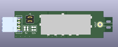

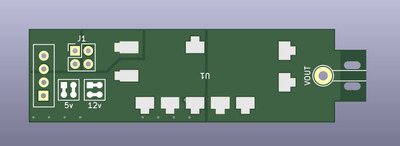

Reply 105 of 223, by CalamityLime
Sphere478 wrote on 2022-06-26, 00:27:
That’ll prob do the trick. :) good job! […]
The PCB is 18mm wide and the module is 14-ish mm tall, so you'll want a nice big shrink tube if that's your route.
A fan, I don't know, what's the most heat this thing can produce on paper?
Vin: 12v, vout: 1.8 = EFFICIENCY: 83.3
So 13 amps at 1.8v produces around 8 watts of heat?
So worst case it gets a little too warm for my liking in a tube but it's uncommon for a user to sustain that kind of a load so meh.
I really didn't know where else to put the the dip switch to make life easier but I did try to leave blank space for any blade in the area while you're cutting a hole.
What was your previous idea anywho?

Reply 106 of 223, by CalamityLime
Oh yes, forgot to note.
I added a LCSC product number to a few bits. I think the caps and the dip switch, not sure about anything else.
Open the schematic and bring up properties of the part.

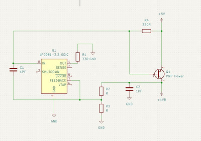

I poked around my board a bit and it seems that this is the schematic for the linear power supply of old.
Should still be able to make it today and up to 15 amps with a good PNP. You can set the vout with this formula: 1.235 X (1 + (R2/R3) ) = vout
