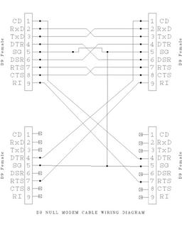

Reply 4 of 9, by superfury
Just adjusted the little image of the wiring of the cables from Wikipedia to show how UniPCemu assumes it is (although one of the two bottom's wires might be ommitted and grounded instead).
136.87 KiB
1493 views
UniPCemu's assumed dual port null-modem wiring
UniPCemu is then connected to one of the top serial ports as the primary port, on the same side the bottom one for the control port. The device that connects to UniPCemu is then connecting using the top port on the opposite side.
Said setup could even be used to provide a virtual DCE-DCE connection using 4 DTE driving ports.
Although I don't know if the opposite (unused) port at the bottom of the diagram should be grounded in the case only 3 are used (either top left, bottom left (for UniPCemu emulating the DCE) and top right(for the DTE connecting to UniPCemu) or top right, bottom right (for UniPCemu) and top left(for the DTE connecting to UniPCemu)).
Although full DCE-DCE communication using 4 DTE ports could also be done when implemented as in the image.
UniPCemu Git repository

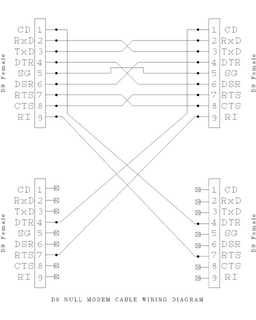

Reply 5 of 9, by superfury
OK. A slight revision of the cable, with signal ground (pin 5) connected on all four devices:
137.19 KiB
1459 views
Revised version, with signal ground added.

Reply 8 of 9, by superfury
Perhaps it's better to simply remove the bottom-left connector and connect it's DTR output to the right-side DTR as well? And the same with RTS?
So bottom-right connector changes to:
DTR(bottom-right)->CD(top-left) and CD(top-right)
RTS(bottom-right)->RI(top-left) and RI(top-right)
And the bottom-left connector removed (leaving cables between the top connectors and some wires to the bottom-right connector only)?
Or, starting out with a normal null-modem cable, just connect RI pin(top-left) to a breakout connector(bottom-right) RTS pin instead, the same with top-left CD pin (requiring disconnecting from DSR's signal first) to the breakout connector DTR pin.
The top two connectors are from the normal full-handshake nullmodem cable, with all but those two pins unmodified.
