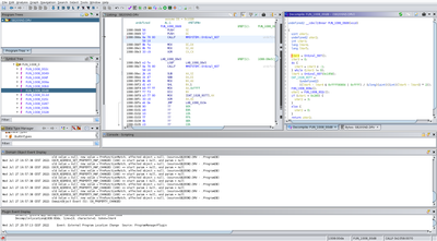

The windows 3.1 sound blaster 2.0 driver suffers from a potential divide per zero error if two successive calls to timeGetTime() returns the same value during the driver initialization.
236.74 KiB
440 views
This is a patch to fix this, changing the driver to act as if the difference between the two calls was 1ms.
I needed it so I can use LPTDAC.386 on my Armada M700, so let's share it.

Azami wrote on 2022-07-29, 23:28:
Yes, it's Ghidra.
Then manual patching with an hex editor.
Nice. I've used IDA a lot but always been frustrated when I attempt Ghidra, particularly with code that doesn't cleanly lie inside any function.
