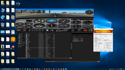

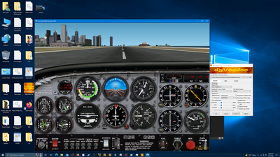

An issue introduced with dgVoodoo since version 2.78 is that in Flight Simulator 2002, 2000, and CFS2, whenever the 2D cockpit and popups like a compass are brought up and closed, the game's window size is approximately cut in half vertically, and doing so repeatedly makes the window extremely small to the point of leaving the game unplayable as I would have to size it back up to normal.
Spoiler
How it starts and should remain:

I just turned on the compass popup panel on the top right, and the game window turned small:
The attachment FS2002 (2).png is no longer available
When it gets very small:

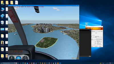

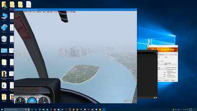

While the same issue isn't present in Flight Simulator 2004, haze (when weather visibility is reduced or it rains) is not rendered at all at times and thus scenery that should be obscured is perfectly visible until a cut off. It occurs whenever the 2D cockpit is reloaded, and it goes away temporarily when changing display settings. I do not know from which dgVoodoo version the issue first became present.
Spoiler
Haze is not present:

Reply 1 of 4, by Dege
I fixed the window problem, but what is the easiest way to reproduce the haze issue? I'm completely dumb to this game. 😀
Reply 2 of 4, by Torturephile
Thank you very much.
As far as replicating the fog disappearing issue for Flight Simulator 2004, just switch planes (menu bar -> Aircraft -> Select Aircraft...) while playing. To bring the fog back, tinker with any of the hardware display settings (menu bar -> Options -> Settings -> Display... - > Hardware -> Hardware rendering options). If you like, I could make a video showcasing the problem.
Reply 3 of 4, by Dege
Ok, thanks. I think I figured out what the problem was. I've just released a new WIP with the fix, let's check it out.
Reply 4 of 4, by Torturephile
Works perfect. Thank you so much.
