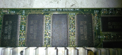

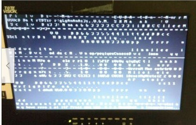

Motes of crumbs and strange text scattered all over in boot up POST. This is from seller's photo.
https://www.ebay.ca/itm/265889123717
The card is on enroute to me, made by STB, AGP card.
I have soldering skills so SMD repair, electronic test tools is not a issue. Due to my job, I have to deal with this daily repairing cell phones and tablets means I use hot air station and soldering irons.
I plan on replacing the dram IC as I have source to get new 6ns ICs but I could not find any 5ns SDRAM 1mbit x 16 bit 3.3V ICs 50 pin TSOP.
Received the video card and went to repair that thing, hopefully the big bucks not wasted on it.
Artifacting was scratched tracks in memory bus area.
Blank jailbars was bad memory chip somewhere, I replaced them with new micron 6ns sdram from USA selller on Ebay, instead of samsung, replaced three electrolytics with MLCC capacitors and the smashed tantalum for MLCC capacitors. All the MLCC capacitors were salvaged from junk video cards.

Might just be a partially corrupted vBIOS/character ROM (or not) or maybe bad solder. I hope it's an easy fix .
EDIT : For SDRAM chips, you might be able to harvest some from other otherwise dead/sold for parts cards.

Reply 4 of 10, by Intel486dx33
Looks like bad ram chips. Most likely the solder joints have broken on the ram chip legs.
You can reflow the SMB ram chips by putting some solder paste on ram chip legs and heat with an heat gun.
Set you heat gun to melting point of solder which I think is around 215 degrees F.
Just heat the solder paste until it melts an let the solder paste do all the work of repairing the welds with the ram chip legs.
Should only take a few minutes to reflow all the ram chips.
Don’t move the ram chips just let the solder paste do the work of fixing the solder joints.
I fixed a few Voodoo3 cards this way.
See my posts:
Voodoo-3 Evil King Pro Repair
Examples of reflowing with solder paste.
https://youtu.be/2Z7nCAxS2Rg
https://youtu.be/ZypXa9BDXHw
Or you can use No-Clean Flux.
I used NO-Clean Flux as there was NO clean up and it worked great.

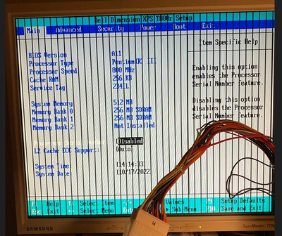

Reply 9 of 10, by pentiumspeed
Had a chance to put together a test bench using a PIII 800 and board.
First picture is from seller photo what it looked before the repair. Second and third photos is after the repair.
Improved than before due to tracks repair but I still have one issue to deal with. I squeezed and warped the card with no change.
Now blank lines one way then another direction depending on what is displayed, here's the two photos:
What causes these black lines?

Reply 10 of 10, by pentiumspeed
Update: I purchased set of Micron SDRAM ICs 10 pieces from a USA seller, waiting to receive memory chips, then try replace the originals.
This fixed this voodoo3 3000 completely after replacing the memory chips. Will post photos once I get iphone charged up enough.
