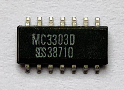

I see in the pic you posted in your thread that your replacement opamp is OC33030. Any reason you went with that particular chip? Was it just what was easily available to you? I'm looking at an ST branded MC3403D.

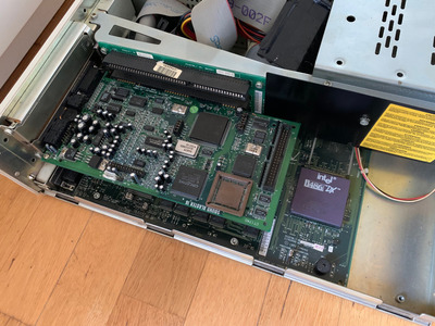

Reply 7 of 9, by Frunzl
ziggy587 wrote on 2022-11-11, 02:56:
Would you find it advantageous to replace all four of the opamps, even if they are currently working?
No. I would also have left all the caps alone, had I known the problem. Some are very tricky to desolder due to the thick ground plane.
If you spotted one that is visually closer to the original, I would go for it!
Actually, the ones I used are the MC3303D (the printing isn't always very clear on the photos). The only difference is the rated operating temperature (0 to 70°C for the 3403 and -40 to 105°C for the 3303). So technically, the 3303 are a little better, but as you suspected, I only chose them due to availability 😀 I do have some spares left, I would happily send you, but I guess postage to the US would be more expensive than sourcing them locally.
Out of curiosity, how did you probe the pins?
See photo below, extremely easy on a riser layout like this.
Nice! That definitely would have been a lot easier. I do in fact have one computer that has an ISA slot on a riser card, but it's a beast of a machine. Still, I probably would have opted for that had I thought of it (I guess that's what I get for trying to do this when I'm tired after work).
