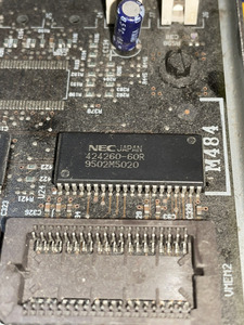

Today I got a nice computer (then maybe I will post some photos) is an IBM Pentium 60 with S3 onboard video card. The problem is that it has graphics artifacts on the screen, which doesn't happen if I insert a PCI graphics card into a slot. I thought of 3 alternatives: video card ram failure, ramdac failure, s3 chip failure… what can it be in your opinion?

Reply 3 of 17, by pentiumspeed
Could be ram, if added, replace with another pair. If the problem still, it is the pair of soldered down memory ICs for the S3.
jailbars is usually ram.

Reply 4 of 17, by AlessandroB
The motherboard has two soldered chips and two sockets. If I desold the two chips, and to test I put two more in the empty sockets, does it work? without welding them in place of the two that I took off. or does it necessarily need the two chips soldered before inserting two more in the sockets?
Reply 5 of 17, by rasz_pl
afaik it needs them in original spot
before desoldering try pushing on the S3 and ram chips (firm push with a finger, discharge yourself to the case first) and seeing if anything changes
Reply 6 of 17, by AlessandroB
I tried but nothing changes. I will have to remove these two chips and find compatible chips. Then place here the model of chip installed so you help me not to make mistakes in buying them
Reply 8 of 17, by AlessandroB
What kind of ram is? the sam as the system EDO ram? can i take from a 72 pin simm?
Reply 9 of 17, by pentiumspeed
No, needs t0 be 256k x 16 bits SOJ 40 pins IC. Please provide pictures of S3's memory chips markings.

Reply 12 of 17, by pentiumspeed
That's fast page mode, 60ns. Get two and have someone who have hot air station replace them for you.

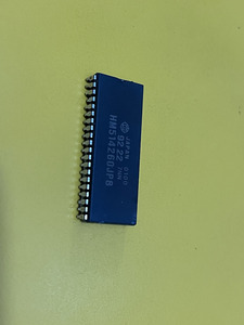

Reply 15 of 17, by AlessandroB
I have found two of this... are useful?
Reply 16 of 17, by mkarcher
AlessandroB wrote on 2023-01-17, 13:12:
The digit "8" in the end indicates 80ns. I would recommend against soldering those to the board as replacement.
