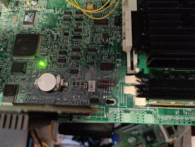

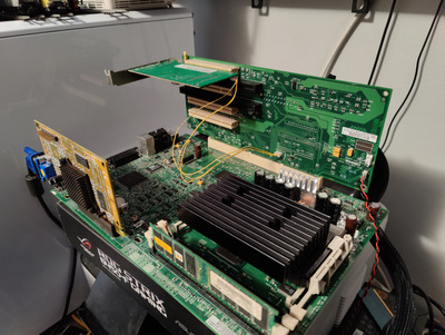

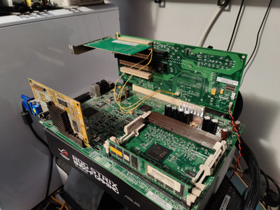

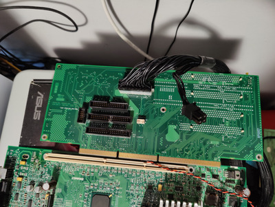

I got my hands on this old odd form factor Compaq 010271-001 revA slot 1 motherboard with a i440bx chipset, in the hopes of finally getting to test my slot 1 CPUs.
Unfortunately i haven't been able to get it boot. As far as i can tell, the board turns on, the CPU does get warm to the touch but not much more happens. No beeps or such.
What i have tried so far is trying out other CPUs ( I have 2 Pentium II Klamath 233 and 300mhz and 2 Pentium III Katmai 500 and 550mhz CPUs, all of them behaved the same), trying different ram, different video card, and playing around with the speed settings, but still nothing came up on the screen.
Im not sure if this board sets the FSB speed automatically, as it has support for both 66 and 100mhz, but no toggle to set it manually, so that might be causing problems too.
Not sure if i missed anything or im doing something wrong, so ill attach some pictures of the board on my bench
If anyone has any idea of what i should try to get this board working, please let me know.
Thank you very much 😀

Reply 1 of 16, by drosse1meyer
I assume you've cleared the bios and removed the battery and all that? Also I would get a proper battery
Otherwise standard suggestions - get a POST card so you can get a better idea of what's happening, maybe start replacing those big capacitors, etc.
No beep codes or video could mean an issue with the board, doesnt like the CPU, BIOS is bad, etc.
Reply 2 of 16, by Doornkaat
Is it possible you need to push down on the yellow switch on the riser PCB when running this board?

Probably won't help, but there is space for a jumper marked SPD66, just up from the space for the jumper marked 'spread disable'.
Is the battery holder ok? Looks like a bit of foil in there, might be worth checking that it's not shorting the battery.
[edit to add: oh, maybe try moving SW6 to on, should try to boot as soon as power is applied. I might have missed it, but is there a buzzer on the board, or an obvious speaker header for beeps?]
[looks like maybe space on the board, near what I guess is an LPT port, for a speaker]

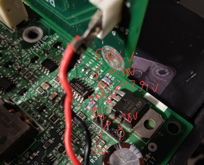

I did try to add a fan, but from i managed to probe, voltages on the fan conector next to the slot seem a bit off. I was getting 10.6V on what i assume to be the 12v pin, and 5v on the pin all the way on the right, but the fan i conected wouldn't spin up at all.

Reply 9 of 16, by AshleyK
snufkin wrote on 2022-11-30, 17:18:
Probably won't help, but there is space for a jumper marked SPD66, just up from the space for the jumper marked 'spread disable' […]
AshleyK wrote on 2022-11-30, 13:14:
Oh, thanks for pointing that out. Just tried to bridge that, and still got nothing 🙁
The battery holder is fine, i used that foil to adapt a CR2032 as i don't have the right battery for it.
SW6 appears to be inverted for some reason. When its set to off (aka turn on only when pressing power button) it fires right up every time and vice versa.

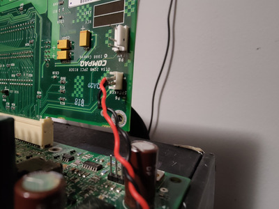

There is a speaker conector on the riser board, to wich i hooked up a regular pc buzzer (the red and black wires in the photo) but there is nothing coming out of it

I got beeps!
Apparently the buzzer i was using was dead...Odd. So i got another one hooked up to the board and i finally got something out of it. There were 3 beeps, 1 short and 2 long after 35 sec and no video, for both Pentium II's and the 550MHz Pentium III, with or without ram and video card. My 500MHz Pentium III however only got 1 short beep, almost as if it was posting, but still nothing on the screen.
I have recorded these and have attached them below (the noise in the background is a hard drive i used to know when the board is powered up)

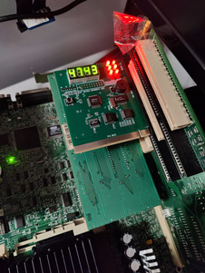

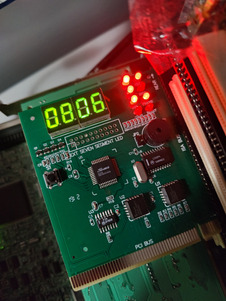

Managed to get a post card of my own! And this is what it shows.
When it first boots, it shows 08 06, and when the beeps happen, 47 43 gets shown, and stays like that till powered off.
Reply 16 of 16, by PC@LIVE
Exactly I don't know what those codes mean, it depends on the bios it has, usually those used commonly are Ami and Award, but it is possible that your card has a personalized compaq one.
I could advise you on the use of an ISA VGA, if you have a screen with that, it is easier to understand what does not allow the start.
