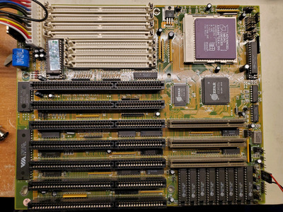

Hi there,
I was wondering if we could have a discussion about memory channels dead or dyeing on their 486 motherboard and maybe what the cause could be.
At first I thought I may be just unlucky. But I've had so many boards now with dead 72 pin mem slots I thought it would be worth mentioning. I had a 486 board with three (3) out of four (4) 72 pin slots dead. I currently have two 486 boards with two (2) out of the four (4) slots dead. and I just picked up a 4th board that has all four (4) 72 pin slots dead but none of the 30 pin slots.
I've been seeing this so much with my 486 motherboards I thought it would be worth a discussion. Has anyone else experienced this and does anyone know what the most prevalent cause of this may be?

That's odd. Never seen it (other than plastic clips breaking off) despite more than enough boards.
I'd say one of two things is up:
- where you live there are environmental conditions that the boards don't like (maybe hot & very humid?)
- misdiagnosis, the slots aren't really dead, just not accepting what you test them with.
Double check regarding the latter:
- are you testing with FP 72p SIMMs, not EDO? EDO support in 486 boards is uncommon.
- some boards habe trouble with double sided SIMMs. Best test is single-sided 4MB SIMMs with 8/9 chips.
- regarding 9 chips: some boards require parity SIMMs. Ruled that out?

I feel dumb. With the information I learned in this thread, I went back and scrutinized my configurations against the manuals. Sure enough, the boards are extremely specific as to what can go in what slot. That is what I get for doing sloppy computer work. I am pretty convinced I may be the problem here.
Second:
The board that has the 4x 72 pins and 4x 30 pins is a U-Board KS TG919
Third :
Per suggestion by @CoffeeOne let me break down each motherboard and it's specific problem:
Gigabyte GA-486VS REV 7 (REV 8 BIOS): Only accepted a 4Mx36 (16MB) module in Bank 0. Closer scrutiny reveals you cant just toss a 4Mx36 in any slot and expect it to work. You have to progress through the banks. PROBLEM SOLVED
Free Computer Tech 486F38X: Only accepted 4x36 (16MB chips) in Banks 0 and 1. Same thing as the GA-486VA, you have to progress through the banks. PROBLEM SOLVED
VLI-486SV2GX4: Only accepted 4x36 in Banks 0 and 1. Per CoffeeOne I realized only Banks 0 and 2 will accept doubled sided RAM. PROBLEM SOLVED
U-Board KS TG919 Ver 1: This one is a little harder. No 72 pin configuration that I can come up with allows this board to post. I only have two (2) 4MB so if it requires all for 72 pin slots to be populated I can not do that at this minute. And of course I cant find a manual to reference and Retro Web treats this board as a ghost.
I learned a lot from all you feed back. Including that I am an idiot 😁
Are you sure about that? All the pics I see show 3x 72p and 4x 30p:
Is this your board?
Highly unlikely it requires multiple slots to be poulated, the 486 memory bus is 32 bits wide, so 72p modules go one by one.
The manual is on UltimateRetro. The last page indicates supported memory configs, but clearly contains errors (single 1MB SIMM in bank 1 would give 2MB total...?), but reading this, for 72p-only SIMM configs, you should try identical SIMMs in slots 2 and 3.
Just a double-check: does the board work with 30p SIMMs? Otherwise it could be something totally unrelated to memory causing it not to boot...

that looks like version 2. I believe mine is version 1.. Pic uploaded for reference.
there is no issue with the 30 pin simms. I have 16MB in 4 30 pin simms and the board posts just fine with it. I did try two identical 8MB double sided ram in slots 2 and 3. no joy.

Only 4MB or 16MB 72 pin modules are allowed I think. And bank 0 is either the 4 30 pin SIMMs or the first 72 pin slot, you cannot use both obviously, there are only 4 memory banks (while the board has physically 5 banks)

here is what i found for the mem configuration, but it seems a little vague to me. i'm guessing the 1-s indicates one single sided memory module? it indicates it will accept double sided, but doesn't give any double sided configurations?
my concern is the board wont post with any of my 4mb 72 pin modules that i have. tested good in other systems.
Reply 19 of 26, by CoffeeOne
OK, so did you already try a single 4MB module 72pin in bank0 without any 30pin SIMMs?
Bank 0 is the one next the 30pin slots.
