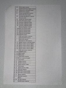

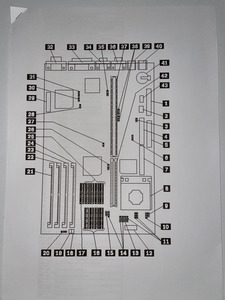

Reply 3 of 10, by AlessandroB
I dis not see anithing like you said

Reply 6 of 10, by CoffeeOne
AlessandroB wrote on 2023-01-13, 16:15:
You must look in the BIOS. It is a BIOS setting, not a jumper setting.
Reply 7 of 10, by mkarcher
CoffeeOne wrote on 2023-01-13, 19:38:
Some boards do not expose the ISA clock divider in the BIOS setup, but rely on auto configuration. In that case, the BIOS measures the processor frequency during POST, and calculates the FSB frequency from that, and then configures a lot of mainboard timings (RAM speed, cache speed, ISA clock divider) depending on FSB clock. So even if one can not find the ISA speed setting in the BIOS setup (it is supposed to appear in the "Advanced Chipset Configuration"), the divider is still configured by the BIOS code.
