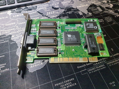

This is the card.
1.83 MiB
485 views

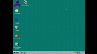

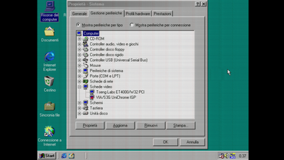

This is the issue. There is no physical damage in the card, it's very clean and nearly mint as you can see in the above photo.
Bands are visible in BIOS and DOS mode too.
Can be bad DRAM chips?
1.19 MiB
485 views
1.58 MiB
485 views

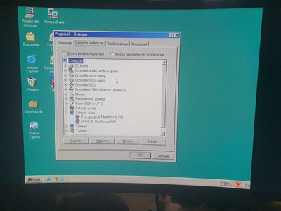

It was the OSSC, this is photo while card is attached to my Samsung LCD.
1.85 MiB
374 views
No more bands\jailbars, the photo quality is a bit crap but I can assure in rl the picture is good. As @darry said I probably tested this card directly with the monitor, I just didn't remembered that.
I'm disappointed by the OSSC, I tried change some settings (LPF, etc) but nothing solved the issue.
Reply 9 of 10, by Tiido
You need to spend some time with sampling settings on OSSC, it is clear the pixel clock that is assumed for the specific input is not quite right and adjustments are necessary. Pixels per line figure needs to change but by how much I don't know.
