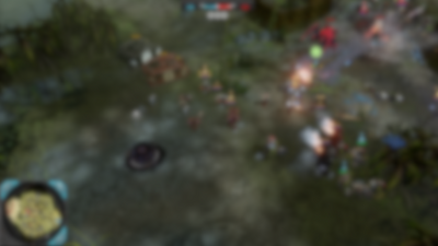

Hello everyone. I am a guy who's trying to push one old little game, Dawn of War 2 - Retribution, into the realm of Dx11, mostly because Dx9 is no longer supported. Now comes the bad part: I have absolutely zero knowledge about how the wrapper works, so I simply dropped the d3d9.dll into the game's folder. This is what I got. Is this a common problem? What could be done to fix it? image.png
Thank you for your time.

Reply 4 of 21, by Dege
Thanks for the report, it turned out to be a bug in the D3D11 backend of dgVoodoo. I've just fixed it and it'll be included in the next version.
Btw, for D3D9 it's much better to wrap it to D3D12 instead of D3D11. Because of performance and other minor reasons.
If you still want to play the game through dgVoodoo then config it to use D3D12, it works with it as expected, I checked it out.
To do that, set 'Output API' to 'Direct3D 12' from the default 'Best available one' on the General tab in the CPL app.
Reply 5 of 21, by Garrick
It worked, thank you very much!
