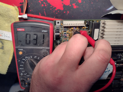

Hello everyone.
I got a hold of a few nice 386 motherboards a while a go, but it seems all of them have defects. Two of them in particular have shorted 12v or 5v rails - I didn't even attempt to power them on. One of these boards has loads of 10uf tantalum capacitors... and all of them test as shorted with all 3 of my multimeters...
This is the 5v rail - my multimeter beeps and the display shows 30 (witch I presume is miliohms).
The attachment shorted 5v.jpg is no longer available
This is one of the shorted tantalum caps. If I remember correctly, they're 16v 10uf. ALL of them seem to be shorted...
The attachment shorted tantalums.jpg is no longer available
Is it possible they have all gone bad or am I doing something wrong?

Reply 1 of 18, by paradigital
If you are testing them in circuit then it’s entirely possible (and to be honest, more plausible) that something else is shorting to ground.
Reply 2 of 18, by Socket3
paradigital wrote on 2023-01-22, 22:14:
How would I go about finding the source of the short circuit?
Reply 3 of 18, by mkarcher
Probably one of the capacitors is short, and all of them are in parallel (on the +5V line). Your meter is in diode/continuity mode. The display is "millivolts drop at a unspecified current aroung 1 to 10 mA", and is intended to show the forward voltage of diodes. You can try to find the cap that shows the lowest value. That one is likely the shorted cap, because at the other caps, you measure the resistance of the 5V/GND planes to the shorted cap as well as the shorted cap itself.
Reply 4 of 18, by pentiumspeed
Only way is thermal camera and lab power supply with 1 ohm 10w resistor in series and look for a warmest tantalum capacitor which means the source of short.

Reply 5 of 18, by aaronkatrini
Just change them all or see the what happens:
https://www.amibay.com/threads/quick-video-of … 2/#post-2445635
Most likely one a few are shorted, but finding it can be difficult and just go the safe route and change them all because eventually all of them will go short.
Reply 6 of 18, by Ozzuneoj
If you can use the methods posted above to figure out which one is shorted, just replace it with whatever cap you have on hand with the same uf and voltage. This will at least let you know if the rest of the board works. If you want to be sure it has a properly specced cap later, swap it out with something more appropriate once you have them on hand.
I would not change all of the caps just because they are tantalums however. The percentage of tantalums that fail is incredibly small, and if they do not fail now they will likely last longer than any aluminum electrolytics you would be replacing them with.

Reply 8 of 18, by Socket3
Ozzuneoj wrote on 2023-01-23, 02:50:
Sounds like a pain in the butt and will probably wear the board out a bit - BUT - it also sounds like the only sure-fire way to find the short... thank you for your advice...
One question tough... would pulling the caps out one by one and testing them in a component tester help find the short? I'd rather not solder in replacements unless they're the correct type...

Reply 9 of 18, by wbahnassi
Voltage injection with a heat camera is the fastest way to detect the source of the issue without desoldering anything yet.
Short of that, it's an adventure of exploration. And it might not be any of the capacitors either, and they are victims to a short by something else (e.g. a diode, a transistor, or even an IC chip) on the same line. Start by looking for any component on the line that looks off (bulged, discolored, cracked). Then desolder it off the board, then test for the short again using continuity mode of your multimeter. If the component you extracted was the source of the problem then the short will be gone. Start putting back everything else you removed and make sure the short doesn't come back. Otherwise you might have found another source of the short (more than one malfunctioning components).
Finally once your mobo is short-free, check to make sure all fuses/0-ohm resistors are continuous. Those often blow when a short happens. Replace as needed. Then you can safely give the mobo a try 🙂

Reply 13 of 18, by Socket3
wbahnassi wrote on 2023-01-23, 12:02:
Unfortunately I don't have a thermal camera... I'm planning on buying one, it's on the list - as well as a proper bench power supply (not an ATX PSU rigged to a breadboard populated by diodes and potentiometers), an oscilloscope and a good electronics microscope.
Thanks for the tips! I'll keep all that in mind when I have a go at the board again.Right now I'm slowly packing, testing and inventorying all my retro hardware so I can install a wall and make a dedicated room for them in my garage - but please keep the tips coming, I'll review this thread in its entirety when I'll be able to work on them.

Socket3 wrote on 2023-01-22, 22:16:
Ideally you would take them out of the circuit to test.
But something I have done before is this: hook the shorted rail up to a variable amperage variable voltage bench top power supply set the voltage to like 1 or two volts and slowly raise the amperage. Using a thermal camera you should be able to see something start to get warm. That’s probably your culprit. (Don’t mix up the polarity) I used this method the other day to find some shorted fets on a charge controller.
You gotta be very careful though.
The safer way is just to pull off the tantrums and replace them. Test for shorts when they are off.
Or if your DVM is really good you may be able to probe around until you found the lowest resistance. That might be your short.
Many of these tantrums are probably in parallel around the board. Measuring one is probably just measuring the shorted one.

What would really help here would be a - milliohmeter - ,
since it's quite common to have multiple caps in the
same power rail in most electronic devices.
With such device would be very easy to tell tiny
fractions of ohms and finding the capacitor with
Must build one one of these days ...
