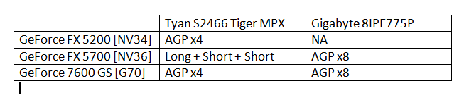

I recently got a GeForce FX 5700 [NV36] to replace the GeForce FX 5200 [NV34] in my Tyan S2466 Tiger MPX system, but much to my surprise when I installed it it the system would not post. When I tried the same card in my Gigabyte 8IPE775P all was OK. This seems really strange as my GeForce 7600 GS [G70] works OK in the Tyan S2466 Tiger MPX. In summary what I see is:
file.php?id=155897
How might I be able to make the FX 5700 [NV36] work in the Tyan S2466 Tiger MPX please?

[table][tr][td]Item[/td][td]Tyan S2466 Tiger MPX[/td][td]Gigabyte 8IPE775P[/td][/tr]
[tr][td]GeForce FX 5200 [NV34][/td][td]AGP x4[/td][td]NA[/td][/tr]
[tr][td]GeForce FX 5700 [NV36][/td][td]Long + Short + Short[/td][td]AGP x8[/td][/tr]
[tr][td]GeForce 7600 GS [G70][/td][td]AGP x4[/td][td]AGP x8[/td][/tr][/table]
