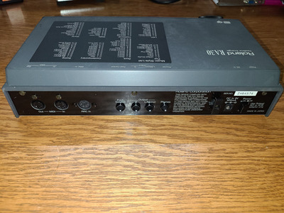

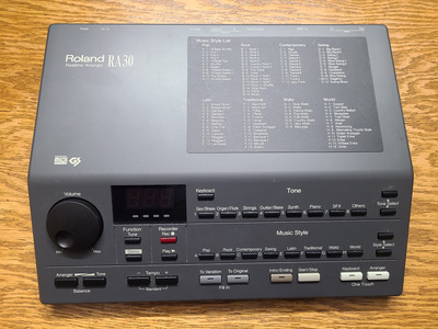

First post, by Ozzuneoj
There isn't much on VOGONS about this particular synth, so I figured I'd make a thread as a repository of basic information about it.
Roland RA30 Realtime Arranger
1.27 MiB
1782 views
1.32 MiB
1782 views
As far as I can tell from looking up specs online, it should have similar MIDI playback capabilities to an SC-55, though with no ability to change instruments during playback from an external source. Since it is intended for music creation, it also has tons of configurable backing beats that it will play back using it's internal GS\GM synth. Reminds me of the old Casio keyboard I had as a kid except with much much higher quality samples.
I haven't tested it with retro games yet, but I played the demo songs and it sounds really nice.

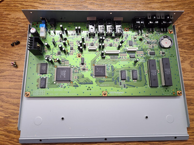

Finally, here's a picture of the internals. I will post more closeups in the next post. Is it possible to tell from this picture what size\quality of samples this would have compared to other Roland GM\GS units of the time?

Also, it looks a lot like the MT-200 (minus floppy drive of course), but it seems to have been made 2-3 years later and has vastly different functions, so hopefully it won't have any of the playback issues that the early MT-200 units had which were documented and fixed in this thread a few years back.

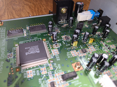

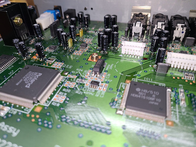

Reply 1 of 17, by Ozzuneoj

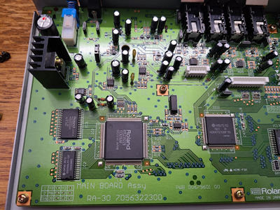

Closer shots of the chips on the board.
1.51 MiB
1776 views
1.57 MiB
1776 views
If I'm reading the date code on the PCB correctly it says July 7th 1995. Not as old as I expected it to be. 😀
Also, unsurprisingly, the usual physics-defying Japanese battery technology means that that CR2032 that has the same red dot QC marking as the cap in the left corner is still good and reads over 3.1v after nearly 28 years of service. Seriously, how do they do this!?!? I have other Roland devices with batteries that are still good after 31+ years. And yes, I've checked it over and there are no signs of tarnish or leakage.

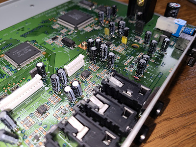

Reply 2 of 17, by Ozzuneoj

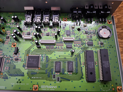

Also, here are some randomly placed pictures of the components on the PCB, since I don't believe there are any other pictures of these online anywhere. May be helpful for replacing caps, etc. some day. Not that it's likely to need any work any time soon with Roland's use of quality components.
1.32 MiB
1763 views
1.14 MiB
1763 views
1.17 MiB
1763 views
1.19 MiB
1763 views

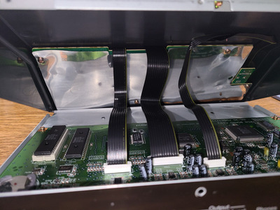

And here's a shot of the ribbon cables that connect the top cover\controls to the main board.

Reply 3 of 17, by Ozzuneoj

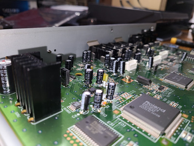

I don't know if this tells us anything, but there is a ROM chip on the board marked as MB838000CPF 0L6 AA , and I found something similar mentioned in this document:
https://www.nightfallcrew.com/wp-content/uplo … VICE_MANUAL.pdf
It says MB838000CPF-G-0L6 and it says it is an "8M Mask ROM (Wave)". So what does that mean? 8MByte or 8mbit? I'm guessing its 8mbit\1Mbyte. More importantly, are there any other Roland modules from the mid 90s that have just one of these? It looks like the SC55MKII might, but I'm having trouble finding good pictures right now.
Reply 4 of 17, by Tiido
Sample ROM is 8Mbits / 1Mbyte which puts it near the SC7 / SCB7 category.

Reply 6 of 17, by Tiido
The main sound chip is same as SC55mk2 (TC6116) so you have 28 channel polyphony. That 1MB holds ADPCM type compressed samples from what I know, which trades space for extra noise but in a big mix with effects on top it won't be audible so it is a good tradeoff. Overall there simply is more care in those samples compared to cheap solutions which goes a very long way, you don't necessarily need big samples to have good sound *coughmultihundredmbytesoundfontsthatfailtoimpresscough* 🤣

It's hard to tell from a quick search exactly where the RA-30 lies, but according to the manual, it has the tone set of the SC-50 (basically, the SC-55mkII set minus the MT-32 tones, 354-128 = 226).
To my knowledge, Roland used delta compression (2:1), so 8Mbit = 1MB chip = 2MB of samples. The SC-55 and the SC-55mkII used 3 x 1MB chips = 6MB samples. The in between SC-50 had 2 x 1MB = 4MB of samples, with the same specs as the RA-30 in terms of patches.
Obviously, there is a discrepancy between 1 wave rom chip that was mentioned earlier and 2. I think there's in fact 2, as can be seen in this picture:
download/file.php?id=156456&mode=view
The chips are the HN6244... ones. I'm guessing these are the 2x8Mbit wave roms.

It would be neat if it actually had 2 x 1MB sample ROMs, but those are 256K SRAM chips:
https://pdf1.alldatasheet.com/datasheet-pdf/v … 256BLFP-7T.html
And the fact that they connect directly to a non-MIDI related, non-Roland microcontroller makes me think that they are just used for running the arranger part of the RA30.
There is also a similar 256K SRAM chip connected to the main Roland chip.
https://datasheetspdf.com/pdf-file/660189/Hit … 65256BLFP-12T/1
There appears to only be one ROM in there, aside from the large DIP chips on the right side, which are probably the firmware itself and maybe the data for the preset backing rhythms.
Unless Roland is known for doing double sided PCBs with ROMs on both sides, then I don't think this could have anything but a 1MB ROM.
Just checked it, there's nothing on the back side of the PCB. Thankfully, it still sounds fantastic. 😁
EDIT: Also, if you want to add this data to your Google Doc at some point, it appears that the RA30 uses an NEC UPD6379 DAC and an NEC UPC4750 OpAmp.
Reply 17 of 17, by Tiido
the socketed ROMs are program code + data for the CPU, along with the two SRAMs. PSRAM next to sample ROM is effect memory.
