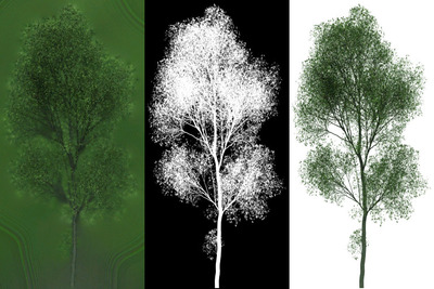

We need to separate the problems.
1. Bug with Rectangular tree. I see this bug without dgVoodoo. He maybe separated from bug 2, or be "parent" for bug 2. No need resolve.
Your screen without AA (aliasing around mirror). But I see bug if forced set in driver MSAA/SSAA or set in game Anti-Aliasing = Normal / High / FXAA. If use Reshade with FXAA or dgVoodoo MSAA or dgVoodoo with set AA in game - no rectangular trees.
I found this post dated 2013 year https://steamcommunity.com/app/211970/discuss … 27315330543807/
2. Ordered dithering or "dotted pattern" for trees, trees shadow, wire fence shadow. If only I see this bug, probably my problem. No need resolve.
I see this effect only with dgVoodoo or DXVK. In native mode it's OK.
Your screen without "dotted pattern", so there is no problem with shadows. Maybe I not right, but I not see difference between ordered dither and dotted pattern for visualise. Maybe for rendering it's important difference.
Maybe it's combine only my software/hardware with dgVoodoo. Maybe dither it's hardware/firmare method for replace transparency/alpha for some format textures for AMD video card? You say "D3D9 does not support dithering anyway", dgVoodoo may changing texture format after wrap to DX11? Very many "maybe".
Before send this, I use Regedit and found in AMD driver hive with two keys AAAMethod_DEF = 0 (not sure, Adaptive AA or Alpha AA) and DitherAlpha_NA = 1, I will try change this keys, but not soon. But in native mode it's OK.
3. No reflection.
I don't have an idea. If I understand, you know how to fix it.

1. Are you sure MSAA in dgVoodoo it's MSAA? dgVoodo MSAA=2 use 1370 mb, it's more more than set in driver MSAA=8 with 907mb memory. Even if dgVoodoo without MSAA use +301mb (727-426) than native mode without AA in driver and game AA=off. For dgVoodo MSAA=8 not enough 3072mb vs 907mb for set in driver MSAA=8 with FullHD.
2. Consuming video memory in game with set in game AA=Normal / High / FXAA it's +50mb more then with driver MSAA=4 (717mb vs 660mb), but 190mb less then driver MSAA=8 (717mb vs 907mb). Activate MSAA/SSAA in driver give rectangular tree too. In game AA Normal / High seems like MSAA. In game FXAA it's myabe combined MSAA+FXAA, because use very many memory for standart FXAA, but near if driver MSAA=4.
3. dgVoodoo MSAA=App work as MSAA=Off. I start game after change AA in driver, and will try change AA in driver than game already run, AA not work and game always use 728 mb. In native d3d9 AA driver setings work normal before and after start game.
4. dgVoodoo MSAA + driver SSAA = made little blur for all screen. Test in dgVoodo 2.79.3 and WIP 89.3.
Zoom x2 (lefft picture is dgVoodoo MSAA=2 with AA driver SSAA=2; right picture dgVoodoo MSAA=2 with AA driver=App/ MSAA )
