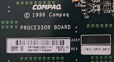

I cannot read the labels on the board which are some what crucial as to figuring out what exact board it is....and the system it cam from.
With out that info is hard to steer you to the proper place here: http://cwcyrix.duckdns.org/ftp-archives/ftp.compaq.com/pub/ or here https://ftp.zx.net.nz/pub/archive/ftp.compaq.com/
Do not take this wrong but what did you take the mobo picture with ? (my antique CDMA phone comes to mind ;p ) You do know you can attach pictures direct here as long as you try to keep size down to a few MB in size....

Just snapped a pic with my phone (pixel 6a).
Click the pic and you should get a much larger one, I can certainly read the small print.

Yeah your picture is fine, was my browser not co-operating 😀 Attached the expanded label as it may be helpful to find the board.
Tomorrow will dig thru and see what I can find...

Compaq Deskpro 2000 QRG - https://web.archive.org/web/19961226054153/ht … me2/dp2000.html
Looks like the latest(?) ROMPaq is SP15803
sp15803.exe

If you're still looking, I've added appropriate Setup/Diagnostic softpaqs (sp12906 / v10.39 Rev A and sp16085 / v10.40 Rev A) - reason I added both is that the later version removes Setup as a menu option on (then?) current products, so one or both should be OK.
