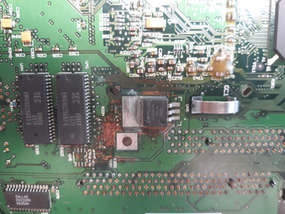

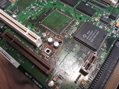

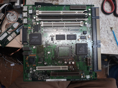

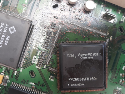

Unfortunately the processor was severely corroded, and when it touched its legs, it ended up breaking.
I think I found a somewhat workable solution: I have an old ibook g3 500mhz dual usb that suffered an accident, and the only good thing left on it was its motherboard. I will adapt it to the case of the performa by adding 7 USB ports. It's not perfect, but at least it will keep close to the time and run what I wanted to run on it.
