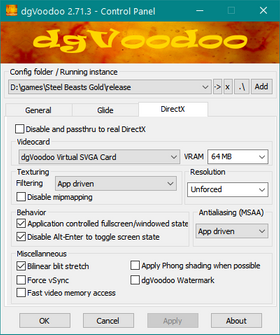

I'm using latest Steel Beasts Gold 1.226 with dgVoodoo 2.79.3 on Windows 10 (default directx settings minus watermark), Geforce GTX750Ti. Resolution: Unforced (640x480)

Reply 1 of 5, by feda
Select Virtual SVGA Card instead of 3D Accelerated. (SB1 doesn't support 3D hardware)
Reply 2 of 5, by user981
Selected, did not fix the problem.

Thanks for the report, I think I fixed it. See WIP 89.5:

Reply 5 of 5, by user981
Dege wrote on 2023-03-09, 21:36:
user981 wrote on 2023-02-21, 21:29:
I'm using latest Steel Beasts Gold 1.226 with dgVoodoo 2.79.3 on Windows 10 (default directx settings minus watermark), Geforce […]
Problem: there is thermal view in game that have to look like that (screenshot from virtualbox):
but instead it looks like this (wrong colors and targets not marked with proper color of "heat" - in our case - white:
To test it: start the game: open Tutorials - 04 Leo Gannery D, turn left to the target, to enable Thermal view: press numpad+, Zooming: N, there is addition switch for thermal color palette - Numpad -
The same bug can be seen on youtube video from another user: https://youtu.be/8ehiYX1XL5E?t=1902
P.S. Big thanks for the program!
Re: dgVodooo 2.7.x and related WIP versions (2)
I did some brief testing and it appears the bug was fixed in Steel Beasts, thank you. I will let you know in case of any side effects.
