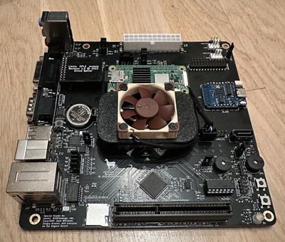

The ITX-Llama is my second major project (after the TinyLlama) using the versatile Vortex86EX system-on-module (SOM).
It has a true x86, P6 (Pentium Pro/II/III) compatible CPU running at anywhere between 100-500 MHz, with 16 KB of L1 cache and 128 KB of L2 cache (both of which can be disabled), 128 MB of LPDDR3 RAM and an 8 MB ROM chip.
The CPU speed is roughly comparable to a Pentium 233, or somewhere in that neighborhood, depending on the application/game.
The mainboard has been designed to be as close possible to my dream late-DOS, early Windows 98 system as I could get, given the constraints of the CPU/SOM.
Here are its main features:
- ATX power connector. You can get away with just about the weakest PSU possible, the system doesn't draw much power.
- 3.3V-keyed AGP connector, running at 66 MHz and "1x" speed. AFAIK, most 3.3V and "universal" AGP cards should work fine, albeit at a slower speed than in a true AGP system. The reason for the 1x speed is that the SOM only provides a single PCIe lane, which is fed to a PI7C9X118SL PCIe-to-PCI bridge. AGP will happily run on PCI signals (it's a superset of PCI after all), but without AGP-only features like sideband-addressing.
- 2 USB 2.0 ports
- PS/2 keyboard and mouse connectors
- 2 USB ports that can be used for HID devices (keyboards and mice), that are translated into PS/2 using a dedicated RP2040 chip. Use jumpers to choose between real PS/2 or USB HID for both keyboard and mouse.
- 10/100 Mbit Ethernet RJ45 connector
- RS232 Serial port
- Internal TTL serial port
- Gameport
- Audio ports (line out, line in, microphone in)
- Digital optical audio out port ("Toslink")
- Analog CD audio input connector
- SATA connector
- PC speaker
- Front panel connectors (power switch, reset switch, power LED, HDD LED)
- PC speaker connector
- Power and reset buttons
- Multi-purpose RGB LED for showing power status, HDD activity
- Micro-SD card slot
- "HDD clicker" for SD card activity - for emulating the sound of spinning hard drives
- Built-in Crystal CS4237B-based sound card. Adlib, SB Pro 2, WSS compatible.
- Port for connecting an external real OPL3 module (instead of the CS4237B's built-in one)
- Wavetable connector. There isn't room for the old gigantic ones, but modern boards like the S2 and X2 from Serdashop fit nicely.
- 40-pin connector for attaching a Raspberry Pi running mt32-pi firmware - can be used for both MT-32 or MIDI. Both a male and female header, so you can attach a Pi Zero 2 directly, or run a standard 40-pin cable to a regular Pi.
- Built-in PCM5102 DAC for turning the digital audio from the Pi into analog audio that's routed back into the Crystal chip
- CR2032 real-time clock battery
- ESP8266-based serial-to-Wifi-modem for BBS-ing in DOS, dial-up internet in Windows, etc.
- 3 PWM (4-pin) fan headers, 5V or 12V, selectable by jumpers.
- Custom BIOS, based on Coreboot/SeaBIOS. Tweaked to work with this particular system and has a built-from-scratch settings menu where you can customize various things like CPU speed, disks, audio, network, fans, LEDs, clicker sound, etc.

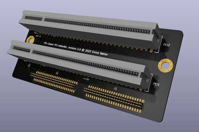

Reply 2 of 433, by sndlbn
I like the spec. What I would like to see is 2x PCI cards. If we are looking for DOS / Windows 95/98 PC, it would be good to have a PCI card plus Voodoo 1/2 device. You can still buy PCI Voodoo 3, but an integrated 2D/3D card is not compatible with many older games. I would like to see Audio In, so you will be able to sample sound or use any older Audio software from this era.
If you pitch for the ITX form factor, will you design a PCI riser card, or will PCI cards be in vertical positions? I think vertical would be more practical due to the CPU cooling if overclocked.

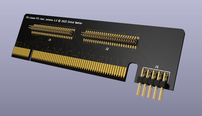

I was originally just thinking of a vertical PCI slot at the standardized location, for compatibility. I guess a 1-to-2 riser card wouldn't be difficult to make, but I'm unsure how this is usually done in practice: most of the PCI signals are bussed (they can just be extended from one slot to the next), but there are a few non-bussed / point-to-point signals as well. Where would the slot 2-only pins be placed on the mainboard single slot..? They'd have to be substituted for other (hopefully non-used pins) I guess. Maybe the JTAG pins? If anyone has knowledge or examples of this, I'd be interested to know!

Eivind wrote on 2023-04-01, 08:10:
I think just a separate pin header or receptacle for the slot-2-only signals will do the job. A riser card could just plug into that directly to pick up those extra signals.

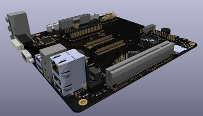

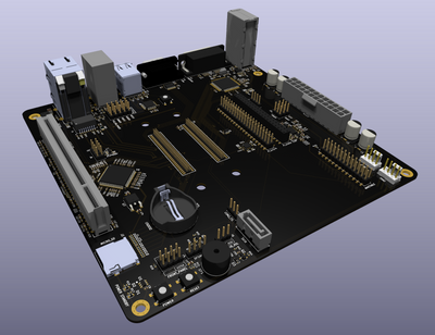

A couple of teasers...

Still waiting for a couple of the components before ordering a sample batch from JLC... In the meantime, here's a first shot at the PCI riser/extender:
