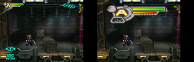

Mega Man X7
With this one dgVoodoo works fine, but setting any value for "Scaling Mode" or "Resolution Scaling" other than "Unspecified" makes the game render menus and HUD textures extremely stretched, so they fall out of the screen. I post a couple of screenshots to illustrate the problem (without scaling at left, with scaling at right).

The other game seems to have the same problem as with others: it's not compatible with non-unspecified scaling mode and forced resolutions because it needs the expected physical window size for its internal calculations. Only the game could be patched to circumvent it.
