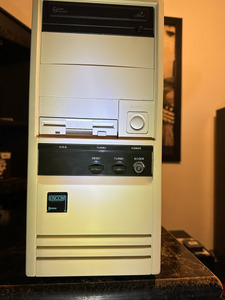

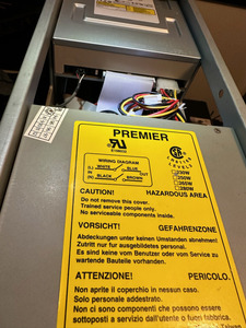

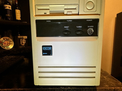

I know is probably another run off the mill build, but I want to share it after finally receiving the last completing piece, one superbly done ENCOM badge (courtesy of mr. geekenspiel)
- QDI P5I430TX Socket 7 Board
- Pentium 133 MMX
- 98mb EDO Ram
- Diamond Stealth 3D 2000 Pro
- Diamond Impact ESS Maestro 2
- Seagate 1282MB ST51270A
Is currently loaded with Win NT 4 but I have a second similar HDD with Win95 which will be used to load a few games.

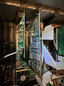

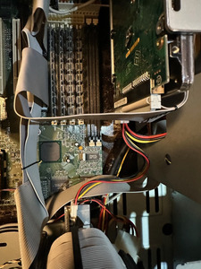

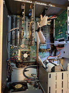

Reply 1 of 7, by Makavre
I tend to be a bit OCD with cable management 😜

Reply 2 of 7, by Irinikus
That’s a very nice looking build!
I usually wouldn’t opt to have a black CD-ROM drive in a beige case, but in this case it looks great, as it compliments the black panel on the front of the case! 😀
Very nice!

thank you, i was really aiming for a "different" look and while it not may be period correct, the system needed to compliment the badge 😀
aitotat wrote on 2023-04-08, 09:14:
Why that much RAM? That chipset cannot cache above 64MB. And why EDO when SDRAM is supported? You should get best possible timings with any PC100 or 133 MHz DIMM.
the board actually supports up to 256mb and was planning to install an amd k6 2 (533AFX) but I ended up using the CPU on a different system (compaq 7470) but since the RAM brackets are really fragile (plastic) I decided to leave it as is to avoid board damage. And to be honest, I built this system to play Stellar7 which doesn't seem affected by ram timings or any other issues. So no practical use for better timings when is already serving my needs.
