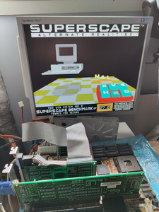

Got this baby today:
https://theretroweb.com/motherboards/s/jetway … i-495sx-3-486wb

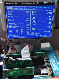

Installed CL-GD5428 VLB, 16MB RAM and Cx486DLC-40, works as intended. L2 cache is 256KB.
Swapped original AMI Bios out to MR BIOS and got memory wait state options with it so memory speed almost doubled.
Only thing that annoys me is that I can't figure out how to take FSB to 50MHz when in 386-mode. With 486-CPU it's possible. I know that 486DLC takes 50MHz.

Strange thing is that I can't get it to work with 32MB RAM, not even 20MB. Only 4 sticks of RAM works. BIOS counts memory and then black screen, or tries to boot DOS and crash.
Reply 8 of 8, by dj_pirtu
Memory problem solved, needed to raise wait states even if memory is 60ns.

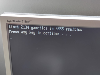

Tried Kingston Turbochip (Am5x86/160) and did some benchmarks. And yes, the legend of Opti chipset slow memory access is true. My SiS471 based 486-motherboard is much faster accessing memory with all bios settings set to tightest. It shows in Doom benchmark and most noticeably in Quake (~12fps vs ~17fps). When using 386 CPU it's not that crucial.
