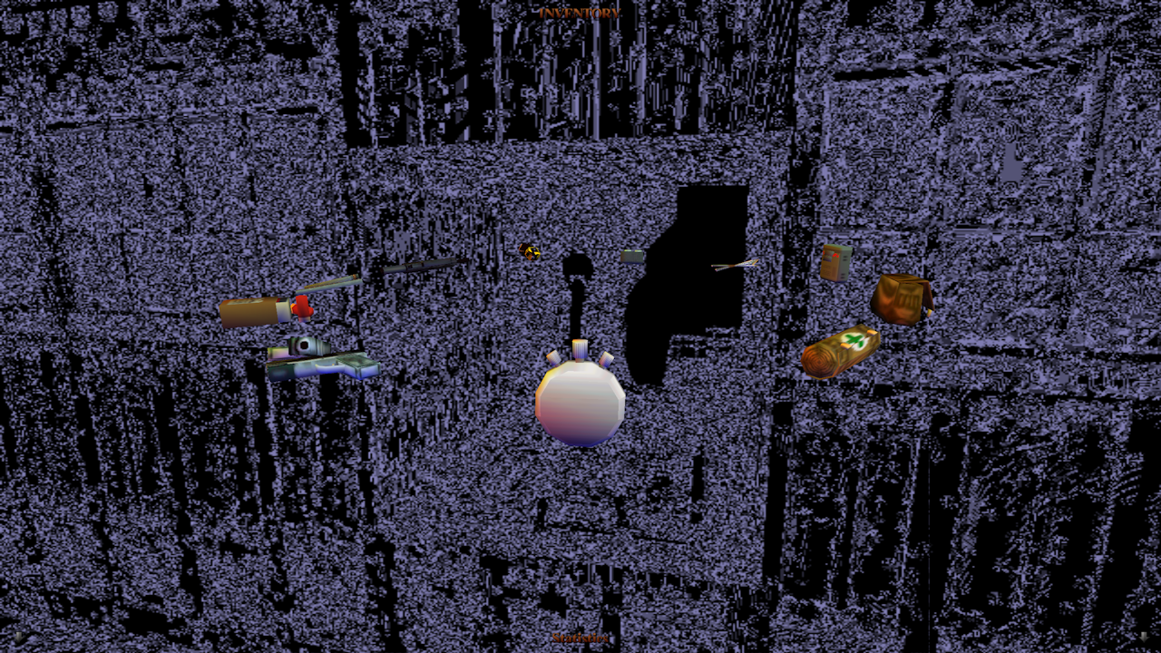

Now of course, using argb2101010 causes the monochrome inventory background screen rendering to break because of the lower alpha bits
So I think, use argb16161616 instead and the monochrome background render is not broken:

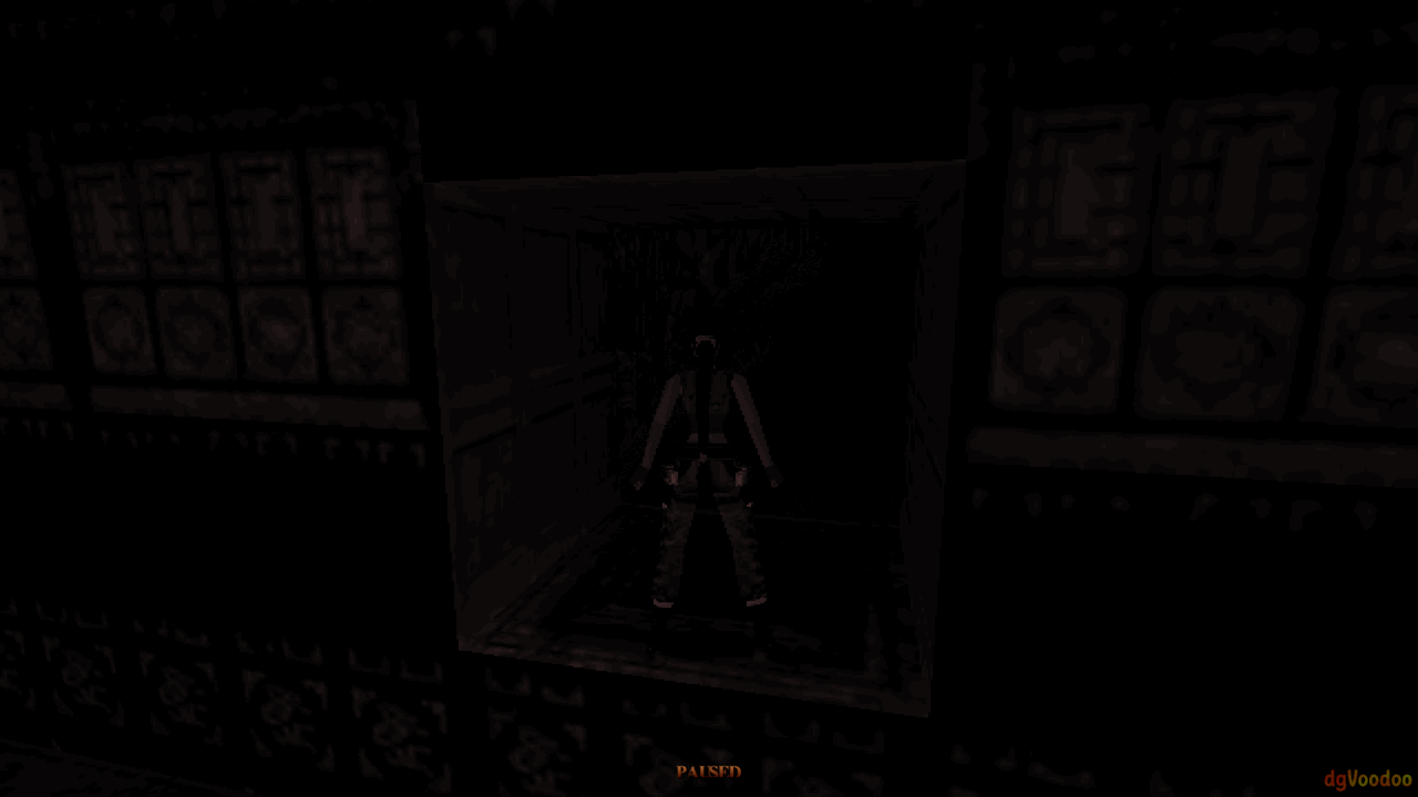

Only thing is, the moment I use argb16161616, the dgvoodoo watermark appears even with it set to off; now if i use argb2101010 or the default: argb8888 the watermark is not present.
.conf attached
Reply 3 of 7, by Dege
dgVoodoo currently does not support argb16161616 at all... So if you write it manually into the config file then it cannot read it (see the debug layer output) and uses the default config instead. That's why the logo is there.

So, the point is, dgVoodoo could render into argb16161616_unorm targets but at the end it must be converted to argb16161616_float for the display output. That's where some precision is lost, because the 16 bit float in the [0..1] interval is 10 bit precision. But it'd be definitely good to avoid lowered alpha bits.
