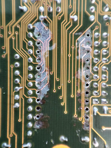

Reply 3 of 8, by aitotat
I just recently fixed one of those FIC 4386-VC-HD motherboards. The problem with that board was that the previous owner tried to fix it (replace Dallas RTC).
He had managed to install socket but it was a mess. Unfortunately I didn't take a picture how it looked at first but everything he had soldered was black. I knew right away that there was likely a burnt trace. I removed the socket and cleaned the mess.
Take a look of all those burned traces
The attachment IMG_20230624_103653.jpg is no longer available
To make things worse, he had first started to accidentally remove BIOS socket but luckily noticed after desoldering only 3 pins. Luckily because one of those three pins now had broken trace as well.
Eventually I managed to fix the board. Be careful. It is very much possible to cause more damage.
