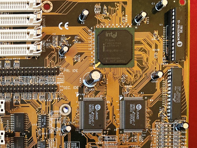

Hello,
I have this 430HX board, and want to run it with obscene amounts of RAM for reasons 😀 However, when I checked the 430HX datasheet I realized that in order to properly cache above 64MB RAM the board needed 11-bit TAG.
755.51 KiB
790 views
How do I achieve this with this board? Do I remove and replace the N341256SJ-15 with a suitable 11-bit TAG IC (does this even exist?) or do I add a second TAG chip to U1 or U2 above?
Reply 1 of 16, by majestyk
You need to add the second TAG chip at the upper right corner for 512MB cacheable area. It has to be the same size as the one already present.
This only makes sense if there´s 512K L2 cache installed. Check the two chips for capacity first, otherwise you must replace them to upgrade from 256K to 512K.

It is a 512K Cache model indeed; there are 2x 64Kx32 Cache chips installed.
So I guess I need to add another N341256SJ-15 (or equivalent) at U1?

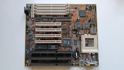

Reply 3 of 16, by majestyk
Yes, and add the torn off electrolytic C42 (if this is your board).
Does the BIOS already have the 64M/512M option? If not, you´ll have to unhide it with Modbin.
My 5DHX had a DIL TAG-chip so I added a DIL socket for the 2nd chip...

Reply 4 of 16, by appiah4
I can't seem to see where the torn off C42 is? Oh wow I just noticed this after you pointed it out! Can you confirm C42 as a 47uF 16V electrolytic? The board POSTs without that cap,but I'll replace it regardless.
I also noticed R72 also looks weird on your board?
I have the 1.80 BIOS on the board, if you already have a BIOS modded for 512MB cacheable RAM option, I'd be grateful if you could share it with me. Cheers!
Reply 5 of 16, by majestyk
This BIOS has the option enabled (it´s called "L2 Cache Cacheable Size"):
5dhx180e.7z
88.05 KiB
28 downloads
R72 is not populated, there´s only a trace that looks like a loose resistor.
C42 is 47µF 16V.

Reply 8 of 16, by appiah4
Thanks for the assist. I replaced C42 with a 42uF 25V electrolytic and all is well. I also checked and my board's BIOS does have the 64MB/512MB Caceable L2 Size option.
So I'm guessing installing this SRAM in a socket would work: https://www.aliexpress.com/item/1005005352245 … id=nuNs1ssLjwFP
Theoretically I can run an MMX 233 with 256MB RAM on this board then?
