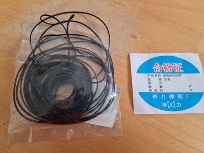

Hi All
I've just reapired the floppy drive in a Compaq LTE Lite 4/33, which was a Citizen V1DA. From what I've seen belts for these are hard to come by - I certainly couldn't find any for sale in the usual places. In desperation I ordered a pack of various sized drive belts from eBay and luckily one of them seems to fit. The length was perfrect. It's narrower and thicker than the belt that came off, but fits and stays on.
The drive is working as of today but I don't know how it will perform long-term obviously.
The belt in question is one of the larger ones from this pack:
https://www.ebay.co.uk/itm/195539070768
Annoyingly I didn't measure it's size before installing , and I'm not prepared to get it back out!
I've attached a photo of the pack for when the eBay listing dissappears.
Hope that's useful to someone.
