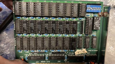

Hey guys does anyone here have an idea what these might be?
One is full of memory banks, the other one: no clue
Reply 1 of 5, by Tiido
One with the big DIP40 chip is a COM port card, the other is a RAM expansion for some XT type machine.

Reply 4 of 5, by mkarcher
Tiido wrote on 2023-07-13, 14:34:
The RAM expansion card has 256K in Bank 1, and 64K in both Bank 1 and Bank 2. The card is extremely likely configured to extend a 256KB PC/XT mainboard (both the 2nd generation PC mainboard and the XT mainboards had up to four banks of 64K, yielding 256KB total) to the maximum "conventional" memory amount of 640KB.
Reply 5 of 5, by mkarcher
Grem Five wrote on 2023-07-13, 16:25:
Yep I don't think I have seen a 5160 that didn't have one of these in slot8.
According to -0°, you need to set the single jumper if the card is fitted in slot 8 (to drive the "CARDSLCT" line on contact B8). As the card on the photo doesn't have the jumper set, it is likely not directly pulled from slot 8 in a 5160 board. That jumper shouldn't be set if the card is fitted into an AT or newer machine, because ISA contact B8 is 0WS meaning in AT-class machines.
