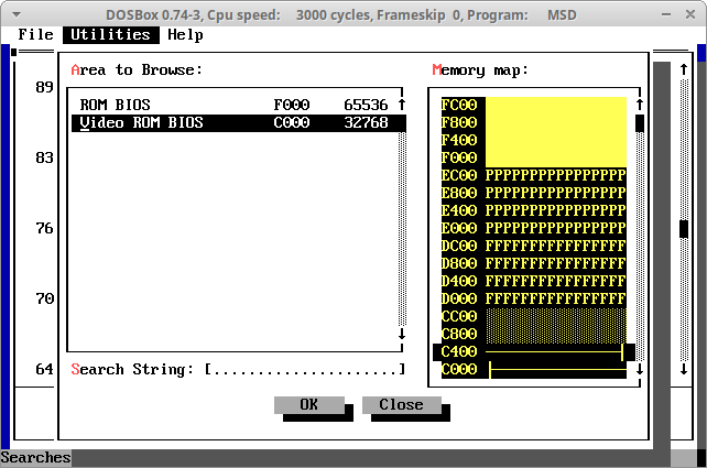

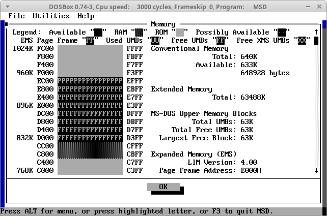

Reply 3 of 19, by wierd_w
I would need to see what your memory map looks like without any memory managers loaded. (No himem.sys, no emm386.exe)
I need to see what the adapter rom region looks like when it is untouched. I could then offer suggestions on where or how to do manual include statements.
You can get MSD as a stand alone zip from winworldpc. It will give me the kind of output I am looking for.
EG-- this is what the map looks like from DosBox, which sets up a page frame and UMBs automagically.
I need to see this for your system with no memory managers, so that I can see where/how/which option roms are in the adapter region.
Some option ROMs are safe to remap with protected mode UMBs with EMM386.EXE with a forced include statement, for instance. Things like PXE bioses and the like. Others, like XTIDE bios, you should not even try.
MSD can give more details about what is what in memory, as it has an option to examine option roms.
Reply 4 of 19, by wierd_w
For completeness, this is the actual map from my dell xps 15.
And this is what umbck from umbpci says.
From this, I can likely (and safely) use
I=D400-E3FF I=EC00-EFFF
I 'might, maybe' be able to get away with including d000-d3ff and e400-EBFF.
(Initial testing says that I CAN include both, but I need to aggressively test.)
