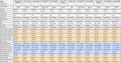

Have a 3DMark 01SE roundup of FX Ultra family (core/memory clock matched), tested on AM2NF3 board with Phenom II x4 :
