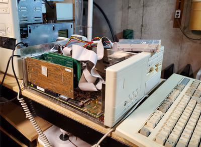

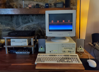

CPU: Am386DX-40
MB: BC3486F w/ 128k cache
RAM: 8 MB
Disk Drives: 3.5" and 5.25" Floppy drives
CD Drive: Mitsumi 4x CD-ROM
Fixed Storage: 256 MB Cisco Systems CompactFlash + CF-IDE Adapter
Controller Card: Biostar FI33290U-IO101-2
Video Card: Diamond SpeedStar 24x (WD90C31) Diamond SpeedStar VGA (Tseng ET4000AX)
Sound Cards:
  • Adlib Gold 1000 with Goldlib Surround module
  • Atrend ATC-6631 (YMF719E-S) + DreamBlaster X2GS wavetable
  • Gravis UltraSound rev 3.7
  • Roland LAPC-I
  • TexElec SAAYM (Game Blaster / CMS + YM2151)
589.85 KiB
2640 views

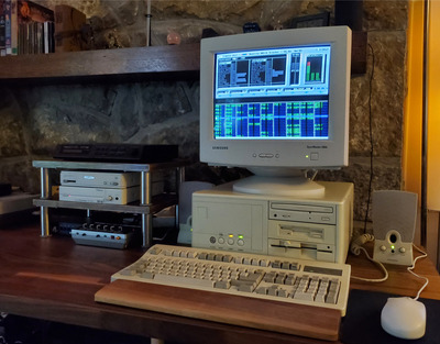

This build was primarily to see how many sound cards I could reasonably fit into a 386 era system. The two main cards I wanted was the Adlib Gold and Roland LAPC-I. Other cards were then selected based on relative compatibility and usability for late 80s and early 90s gaming.
The PnP-capability of the YMF719 card is essential for working with the Adlib Gold. In various tests, I learned that running other cards on the same 388h port does not play well with the Gold.
I use a boot menu to control the YMF719 card for three scenarios: port 388h (FM support), port 3A8h (no FM), and disabled entirely.
The SAAYM and YMF719 card both share the same address (220h). This doesn't really cause any issues unless I want to use the SAAYM. In which case I use a batch file to disable the YMF719 card.

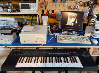

681.41 KiB
2632 views

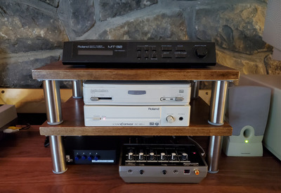

Audio routing is accomplished via an Edirol M-10MX 5 stereo channel mixer and a 4-port A/V switch. I route the Adlib Gold, YMF719 card, GUS and SAAYM directly to the mixer. The LAPC-I is routed to the A/V switch along with any external sound modules. The switch is then routed to the mixer. MIDI is handled via the LACP-I and MCB-1 connector box.
This easily enables me to toggle between sound options for MIDI playback and then mix with any of the other sound cards. I can also mix different audio sources played through different sound cards. For example, digital sound effects or speech through the YMF719 card and FM music through the Adlib Gold.
If I want even more sound options, I also have a Covox Speech Thing clone and a Disney Sound Source that can be hooked up to the parallel port.

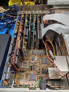

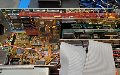

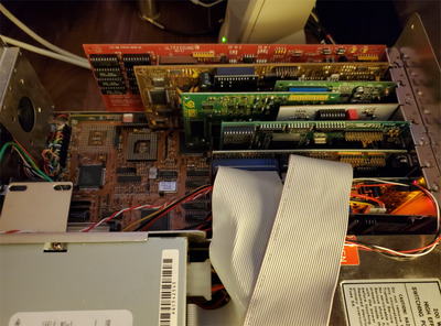

Sound cards are currently configured as follows to avoid as many conflicts as possible:
Atrend ATC-6631 (YMF719)
A=220h
I=5
D=1
P=300
FM=388 or 3A8 (boot option)
Adlib Gold
A=388
I=3
D=disabled
Gravis UltraSound
A=260h
I=7
D=7
TexElec SAAYM
A=220h
I=disabled
Roland LAPC-I
I=2/9
P=330
For the most part, everything works. The exception is digital audio via the Adlib Gold. While digital audio can work, games I've tested require DMA channel 1. Unfortunately, this is also a common DMA channel for many Sound Blaster supported games. As a result, I opted to disable the DMA channel on the Adlib Gold and forego digital sound. It's a non-issue since I can always get digital audio through the YMF719 card.
I do use a wavetable daughter card on the YMF719 card's header. If needed, I use MIDITO to redirect MIDI from port 330h to 300h. This way I can use MIDI either via an external module or the internal wavetable even on games that do natively support custom MIDI ports.

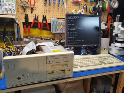

Couple updates on this build and identification of a couple issues.

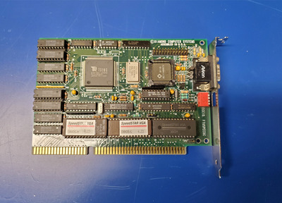

Diamond SpeedStar Monochrome Issue
729.67 KiB
1969 views
First is the video card. For some reason, it periodically detects as a monochrome card instead of color. I did notice this during the original build and testing, but chalked it up to a loose VGA cable. Usually reseating the cable and rebooting the system would fix the issue.
But that problem has persisted in its more permanent setup. I'm not sure if it's an issue with the card or possibly the motherboard. There is a motherboard jumper for switching default monitor settings (color versus monochrome). Removing and reseating the cable still seems to correct the issue, so also not sure if it's a dirty contact or something else.
To test if it's a motherboard issue, I swapped the card for a Diamond SpeedStar 24x. This card is slightly slower in 3D Bench that the original SpeedStar (15.8 FPS originally versus 15.1 with the SpeedStar 24x). It's a ~4.5% reduction in performance, but for playing mostly 2D games I don't think it will be noticeably different.

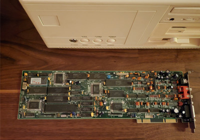

The second issue is the Roland LAPC-I. I noticed in certain games a high-pitched noise in the background. It was most noticeable with Monkey Island and Gateway. It appears that the LAPC-I is picking up or generating a high-pitched whine in this system.
I tried swapping the LAPC-I for a known good LAPC-I from one of my 286 builds. However, the symptoms persisted. I also tested removing all other sound cards and trying the LAPC-I in different slots. In one slot the noise got worse, but never any better.
The high-pitched noise only really occurs during music playback. The moment there is a break in music, the noise fades out after about a second. For soundtracks with higher default volumes it's also less noticeable. Testing games including Waxworks, Elvira, Rise of the Dragon and Settlers, I don't notice the noise. But in Monkey Island and Gateway it's definitely present.

Reply 15 of 17, by Cloudschatze
Shponglefan wrote on 2023-08-08, 15:46:
The pictured LAPC-I lacks a noise-mitigating capacitor change made later in production. Not sure if that's the issue at hand, but, per the attached change information, you can test by simply bending the ceramic disc capacitor at C66 away from the transistor at Q2, and toward the op-amp at IC29.
    LAPC-I_CI.pdf
    560.06 KiB
    74 downloads
Reply 16 of 17, by Shponglefan
Cloudschatze wrote on 2023-08-08, 17:14:
Thanks for the info. I gave that a try, but unfortunately it didn't seem to change anything.
Reading the doc, it looks like the C66 is specific to right-channel noise. Whereas the noise I'm noticing appears to be coming through both channels.
It was worth a shot and good to know about that fix all the same.

Reply 17 of 17, by badmojo
Give this a try: Re: Investigating old ISA VGA cards
