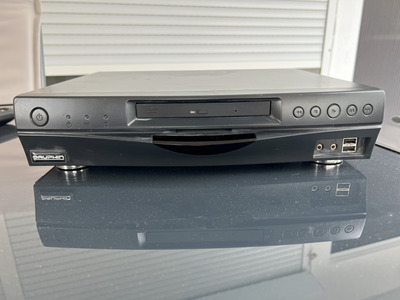

I found locally an interesting pc that I guess had a life as a set top box in the hospitality industry.
I could not find any info on the web about it so here what I found so far:

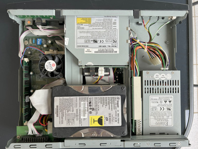

Motherboard is unknown but I can see it uses the VIA VT82C598MVP (Apollo MVP3) and the VT82C686A South Bridge
CPU: AMD K6 2 @450mhz with 100mhz fsb
RAM: 256mb
Hard disk: Seagate 20gb ST320410A
DVD: Quanta SDR-081
GPU: InteGraphics Systems(IGS Company Tvia Inc.) CyberPro 5300 and REALmagic Galaxy 2
Audio: CMI8738 / C3DX (saw this through windows)

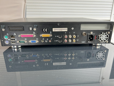

It has a single empty PCI slot available through a riser placing the card parallel to the motherboard. It also features IrDa port for the remote control and smartcard reader (NST NRC2000 device in windows, no drivers unfortunately).

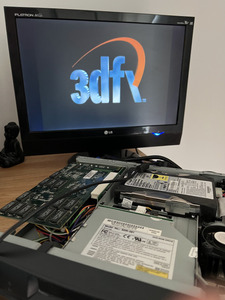

I also tried a 3dfx Voodoo 2 card which runs very nice but the card itself needed to be 2-3 mm shorter as it is very tight with the case closed.
