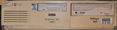

The adventure started a couple months ago when I got the itch to have a Win 98 / DOS PC i n my living room entertainment center. Due to space and format constraints, I was looking for a low profile / SFF machine before I finally stumbled upon this one on ebay.
439.18 KiB
1126 views
219.02 KiB
1126 views
It seemed to possess everything that I was looking for. A slot 1 Pentium something, at least 1 ISA slot, a standard 2.5" floppy drive bay and an AGP slot. There were even a mixed bag of expansion cards installed as a possible bonus. As long as the Motherboard worked, I should be able to combine it with some accessories from my cannibalized 486 machine that ended up to be too limited for my purposes.
Next post will detail what happened a week later when it arrived in the mail.

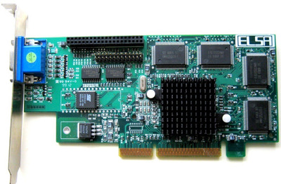

I always asked myself why some graphics cards have a notch at the front...
164.75 KiB
1094 views
And now that i have seen your mainboard i think i know why...

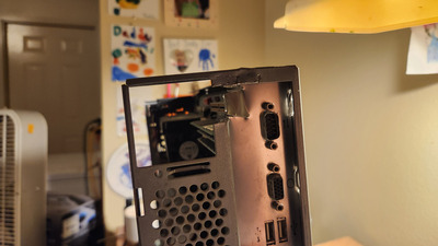

Reply 2 of 12, by warmachine

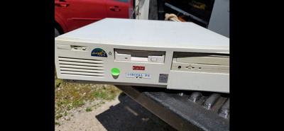

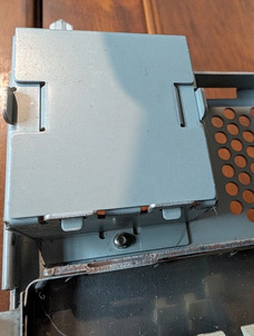

On with the show! Let's see what I got.
927.58 KiB
1080 views
So far, so good.
There are not any dents in the outer case and the front plastics are in good shape.

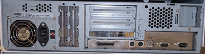

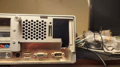

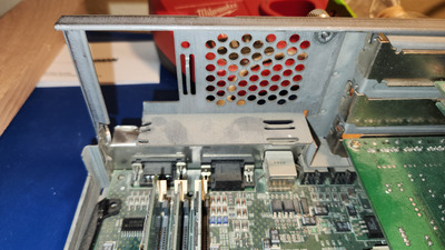

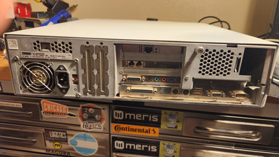

Unfortunately, things are not so great on the rear of the case.
1.25 MiB
1080 views
20230803_172057.jpg[/att3pachment] [attachment=1]20230803_172455.jpg
Appearently, this pc was built to conform to some abondoned quasi-standard called NLX and required graphics card with special low profile brackets. I quess a previous owner wanted
to install a standard AGP card and went a little crazy with the sheet metal shears. So, the rear of the case got hacked up and the internal mounting bracket was missing.
That was a real bummer, i'll probably never find one of those either.
In the meantime, I tried to correct the hackjob the best I could with some pliers and vice grips.
979.51 KiB
1080 views
I can't attach any more images to this post, so I'll continue on with the next one.

DerBaum wrote on 2023-08-27, 00:30:
That graphics card would have probably shipped with an optional
NLX bracket which would have allowed it to be installed in pc's
with this form factor. It actually took me a while to find one at
a decent price. I guess most of them probably got thrown away.

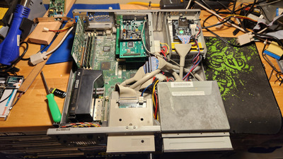

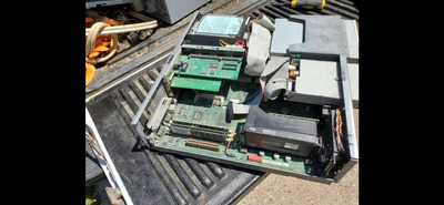

Anyway, let's check out the goodies.
It still has the slot 1 Pentium 2 @ 233Mhz.
Next to it is a socket containing a voltage regulator board. If my understanding is correct, if I wanted to upgrade the P2, I would also have to replace the VRB. It has a full compliment of Pentuim era ports. Serial, paralell, ps2, and 2 USB. The USB ports will only work once the chipset drivers are loaded into windows, so that put a minor hiccup in my plans which I will elaborate on later.
An integrated Matrox Mystique graphics chip with a dedicated memory expansion slot.
An NLX Agp 1.0 expansion slot.
3 ISA slots: 2 of which are shared with PCI slots. In my case, I am using 2 ISA and 1 PCI slot.
Finally, it had 256MB of ram installed.
It came with 2 hard drives installed, but they were expectedly trashed.
I considered leaving one in just for the ambiance of the spinning
hard drive sound, but power is at a premium from this tiny powersupply
so I'll leave it out.

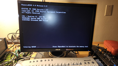

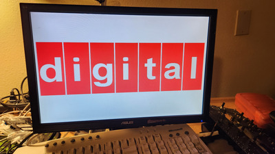

Only thing to do next is to see if it will actually boot.
1 MiB
1007 views
989.13 KiB
1007 views
Success!
Next post will deal with hardware installation.

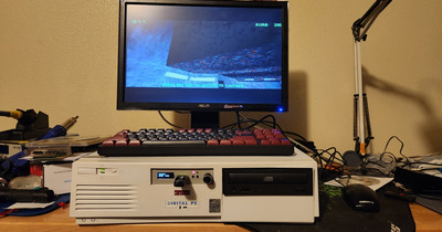

Here is the hardware I chose for this build. Some of it was scavanged from my old 486, some came included with this machine, and some had to be aquired.
The current hardware configuration consists of:
Drives: FlashFloppy modified Gotek with OLED and encoder, Sony CDROM drive, and SD to IDE adapter with 32GB card. I tried to save the included Aopen disc drive, but after replacing
the belt, I found it's performance to be sub optimal so it was replaced.

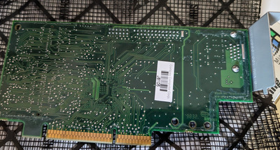

Video: I found an NLX compatible Diamond Viper V550 (Nvidia Riva TNT) Since this card came with a standard mounting plate, I had to look for a correct NLX lo-profile mounting plate
so I could attach it to the case securly without worry that the VGA cable would bend the card or pull it out of the AGP socket.
1.25 MiB
928 views
Sound: The included Yamaha Waveforce WF-192XG partnered with an ESS Audiodrive 1868f Binaura 3D with either a Dreamblaster X-2 or an X-16GS. The Motherboard does not have a PC-PCI/SB-LINK port so the Waveforce will be only used for windows games. That may change if it is possible to build an adapter to connect the PC-PCI pins to the pins of the unused ISA slot.
The Waveblaster X-16GS would be perfect if there were a way to change soundbanks or upload new ones without having to open the case everytime. In the meantime, I am happy enough with the Buran bank on the X-2.
Other: I installed the included Kingston Ethernet card and mounted a Serdaco HDD Clicker.

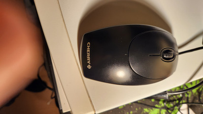

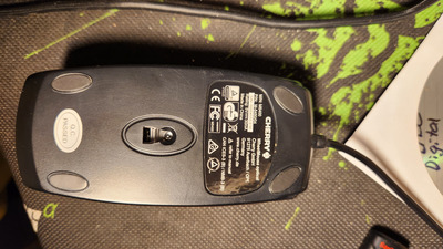

Since I want to install the PC in my entertainment center, I needed a USB keyboard and mouse so I could use extension cables to reach my chair. This presented a problem, since the USB ports have to be initalised by the chipset driver once it is loaded in windows, making a USB kb/mouse unusable in DOS. This required a workaround. The only solution was to use the PS/2 ports, but even if I could find PS/2 extension cables, I didn't want to have to deal with a medocre membrane keyboards and crusty ball mice.
Well, I remembered that USB to PS/2 adapters exist, so I bought a set... and they did not work with either my Corsair K65 mechanical keyboard or any of the optical mice that I had. Ok, I figured that these things had to work with something, so I researched compatible mice and found this.
962.36 KiB
928 views
1.44 MiB
928 views
A Cherry M5400 optical USB mouse.
I'm not sure if these are NOS or new production,
but they are all over ebay/amazon for decent prices. I got this one for less than $10.00 shipped.
I ran out of attachment space, So I will continue with the keyboard solution in the next post.

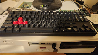

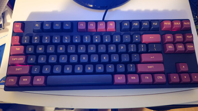

I mentioned before that I didn't want to be limited to just some generic membrane keyboard, so I tried to remember if gaming
keyboards existed that were compatible with the USB/PS2 adapter. After a short search, I found one that claimed to possess this feature.
A Cooler Master CM Storm!
I found one a short time later and at $35.00,
it didn't seem like too big of a risk.
765.23 KiB
848 views
1021.1 KiB
848 views
Sure enough, it worked!
Unfortunately, this one happened to be the stealth version and since I spent the majority of my time in computer lab playing Duke 3D when I was supposed to be practicing Typing Tutor, this would be a slight hindrance to me.
Maybe I should start practicing my touch typing.
Since I had to take it apart and clean it anyway, I decided to replace the keycaps.
853.37 KiB
848 views
It turned out pretty nice!
The old keycaps had windows for the Caps Lock and Scroll Lock LED's to shine through, but they are bright enough that illuminate the general area around the keys enough to be noticable when those features are activated.
Here's an in progress shot of Descent running on the machine through DOS.
1.41 MiB
847 views
I then installed Windows 98 and managed to get a Raspberry pi running retroNAS recognized as a network drive. It's not as optimal as I would have liked, but maybe there are some tweaks I need to do, or I just need to accept that there are limitations to this setup.

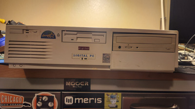

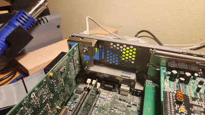

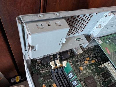

Reply 11 of 12, by davidrg
I'd completely forgotten about this thread when I dug my own Digital PC 3500 out of storage a few days ago and set out to figure out what the AGP situation was with it. Sadly mine is a bit more yellowed but pretty much the same model - 233MHz Pentium II, 64MB RAM. It will be getting Windows 98 just as soon as I find a suitable hard disk for it:
441.39 KiB
276 views
Case front
498.06 KiB
276 views
Case rear (with top cover slightly off)

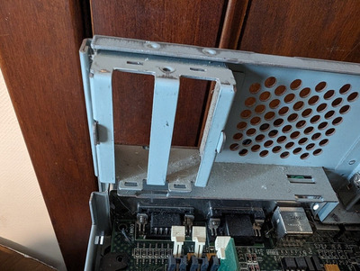

This is what the AGP slot should look like:
254.22 KiB
276 views
60.45 KiB
276 views
The metal blanking plate isn't screwed on or anything so just lifts up and out exposing the weird slot. I assume the top cover is what normally keeps it in place:
240.88 KiB
276 views

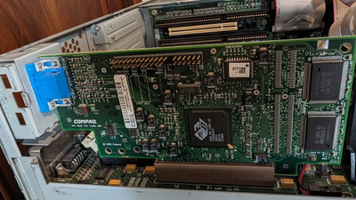

Reply 12 of 12, by davidrg
And someone kindly sent me a compatible NLX card out of, I think, A Compaq Deskpro:
500.99 KiB
274 views
601.17 KiB
274 views
741.39 KiB
274 views
Seems to work fine and should be better than the onboard Matrox video!
