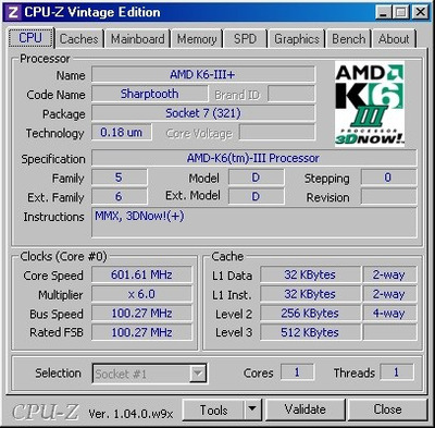

I've been playing around with some socket 7 stuff for a long time now and got side-tracked and honestly kind of forgot about it for most of this year.
Anyway I've finally got my SS7 system to a point I'm happy with and have been using it regularly to play old Win98 and DOS games lately.

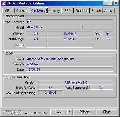

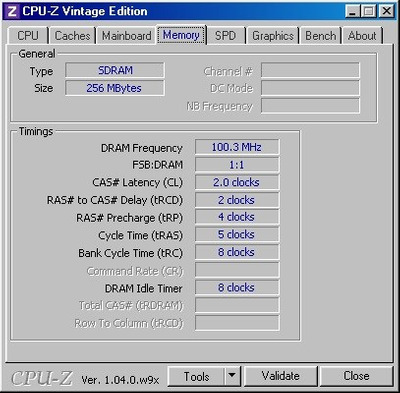

Specs:
ACorp 5ali61 rev D
K6-3+ 600 (modded K6-2+ purchased on ebay)
256MB PC100 CL2 RAM
Radeon 9200 AGP 128MB
LG 52X CD-ROM
Kingston 128GB SD Card
Promise Ultra 133X2
Soundblaster AWE 64
Linksys LNE100 NIC
Techmedia AT case
Coolermaster 460 ATX powersupply with AT adaptor
Win 98SE
Benchmarks:
Quake 3 (1024x768, max detail) - 30.1fps
3dmark 99max - 3301
3dmark 2000 - 3448
EDIT - pics of machine and more benchmark results on the way shortly.

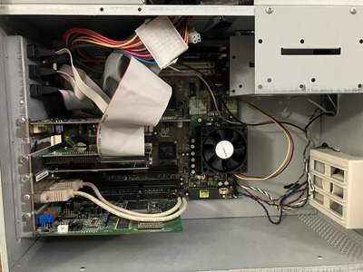

Reply 1 of 44, by pete8475
Internals, front and rear of the computer.

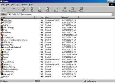

I might experiment with an Audigy to see if I can get optical sound output in 98. Right now I use this machine and my XP Xeon system on a DVI switchbox and take optical sound from the XP machine into a usb converter to my main pc so I can hear the sound through my cordless Sony headphones. That machine has an optical in so it would be no problem to daisy chain this to it.
I've also been trying out a lot of old games from the 95/98 era that I didn't play at the time and am looking for suggestions! So if you have any favorites that you don't see in my installed list in the first post, please suggest them!
