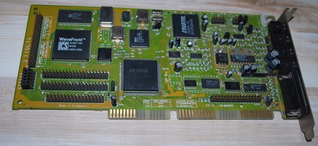

I found this (probably OEM) Aztech sound card. Anyone here has any idea about the model and the correct DOS drivers?
Reply 1 of 44, by DerBaum
Ok. Cool. I really thought i had a complete list of all existing Aztech soundcards...
This one is not in my list. Is this a Packard Bell model?
What i can tell you is that this is a third generation Aztech card.
It is very similar to a MMSN830 (Reveal SC 400) minus the CD Rom Interfaces. Or a MMSN837 (Packard Bell 030069).
You could try the drivers for the MMSN826 (Sound Galaxy Waverider 32+). This card also looks like your card minus the wavetable.
http://vogonsdrivers.com/index.php?catid=54
Interesting on your card is the combination of a original Yamaha YMF262 FM chip-and a copy of the Yamaha YAC512 Digital Analog converter (LS5122).
It doesnt matter and sounds exactly the same... but its interesting anyway 😁
The MMSN826 without wavetable is the MMSN824. Agreed that this looks functionally identical to it, so I'd try those tools (no need for drivrs in DOS).
Paradoxpm wrote on 2023-09-07, 03:46:
Thanks! Do you think it would be feasible to add an external speaker port on the back? The pads seem to be there, but they are unpopulated.
Possibly. Look for a good pic of an MMSN824 to ID the components you need. Add them and it might just work, unless there is a card-specific config blocking that output. Doubt it though, speaker is usually same output as line-out, just amplified.

Reply 7 of 44, by appiah4
That card looks like MMSN842/855 Multimedia Audio Telephony 3200/3260 with the modem part missing so try the audio drivers for that IMO.
Drivers for those cards can be found attached to this post on VOGONS.
MMSN824 will not work that card has a Crystal Codec.

Oh, the OP card looks like a cut down MSN830 for sure!

Reply 12 of 44, by appiah4
Paradoxpm wrote on 2023-09-07, 11:45:
FYI Windows 95 recognized it as a Washington 16. It loads the drivers automatically but no sound.
The AZT chip is common with a Washington and apprently the device ids are the same as well but the Codecs are definitely different and those drivers won't get any sound from this card. Please try the drivers I linked above.

I would not fit the Speaker output.... I would fit the Line Output. (Your card is missing both of them)
The Line output probably works fine and is just on a internal header and the connector for external line out is just not fitted.
The speaker output will require you to fit a lot of resistors, caps and an amp.
