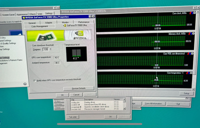

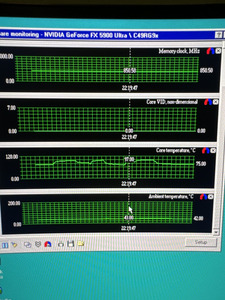

Reply 3 of 13, by wutang61
Photo attached. Quick instant action in mechwarrior 3 back to desktop.
Reply 4 of 13, by kingcake
wutang61 wrote on 2023-10-23, 02:24:
Sorry I can't help much with the temp question, but what software is that shown?
Reply 5 of 13, by giantclam
42C ambient?

Reply 8 of 13, by wutang61
giantclam wrote on 2023-10-23, 05:35:
42C ambient?
Definitely not. Ambient is probably around 23-24c. Makes me think the newer 77.xx forceware is reading the temp probes incorrectly. The system is basically in an open test bench.
The software that is in the screenshot is rivatuner 2.24

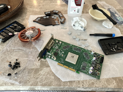

I’ll give that a shot. My gut tells me that it’s a shit mount. Off to eBay we go

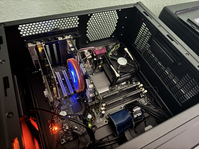

Reply 13 of 13, by wutang61
Well the cooler (Zalman VF900-cu) came in. Thank you for the recommendation. Just have to grab a few extra ram sinks for the rear of the card (or I might not bother) unsure as of yet.
Mounting pressure was the culprit. Remounted with MX-6. Plugged into an empty fan header on the motherboard with bios settings for all fans set to “slow”
Idles around 35c and peaked at 49c running instant action in mechwarrior 3.
Not exactly a high demand title for this card, but the thermals are very much under control. 95c+ isn’t happening anymore.
If you take off the stock cooler on an ultra, the stock mounting hardware is one time use.
Also, card is absolutely silent now. Just have to ditch the old stock intel cooler next as after 20 years I’m sure that paste is just as chalky.
