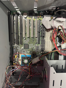

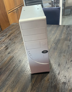

Reply 15 of 24, by ontrca
Gmlb256 wrote on 2023-10-28, 13:47:
For me, the "best" ones are both revisions of DFI 586ITBD and the FIC PA-2013, the ATX power connector is very convenient nowadays.
Both DFI motherboards are based on the Intel 430TX chipset and there is a modded BIOS that allows you to use larger HDDs up to 128GB and adds support for AMD K6plus CPUs. The FIC PA-2013 is the only SS7 motherboard of the bunch, having the AGP slot and 100 MHz FSB setting if overclocking the Pentium MMX is your thing.
I guess I'll start on a DFI 586ITBD 😀
It has 256mb ram at the moment.
166mhz CPU at the moment.
But I'm gonna try the BIOS update that @Gmlb256 suggested 😀 I have an AMD-K6-2/400 😀
NOS tower case. I'm not sure why I like this style of case 😀

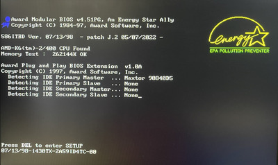

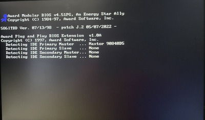

Reply 16 of 24, by ontrca
Repo Man11 wrote on 2023-10-31, 02:29:
Uniflash would probably work, so that's another option.
Uniflash worked 😀
Thank You 😀

Reply 17 of 24, by jheronimus
ontrca wrote on 2023-11-01, 15:10:
I guess I'll start on a DFI 586ITBD :) It has 256mb ram at the moment. 166mhz CPU at the moment. But I'm gonna try the BIOS upda […]
That's a 430TX board, it only caches 64MB of memory. Having 4 times that would actually give you worse performance.
MR BIOS catalog
Unicore catalog
Reply 18 of 24, by Gmlb256
^ Yep, but that limitation can be mostly mitigated by installing a K6-III or K6plus (K6-2+ and K6-III+) CPUs due to them having on-die L2 cache.
